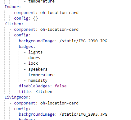

Thanks for the response!
I’m not sure how to revise it given the other badge items in that section.?
Currently mine looks like this.
How do I add the expression ?

I am not quite sure if the dashs “-” are correct in your code, but it should look like:
badges:
lights
doors
lock:
expression: state === 'OFF'
speakers
I suppose…

Those dashes have been there since my original 3.0 install. I’ll play around with removing them.
brianlay
(Brian G Lay)
March 16, 2022, 8:09pm
25
Finally found the solution.
Apparently when you edit the YAML you need remove those lines with the dash
