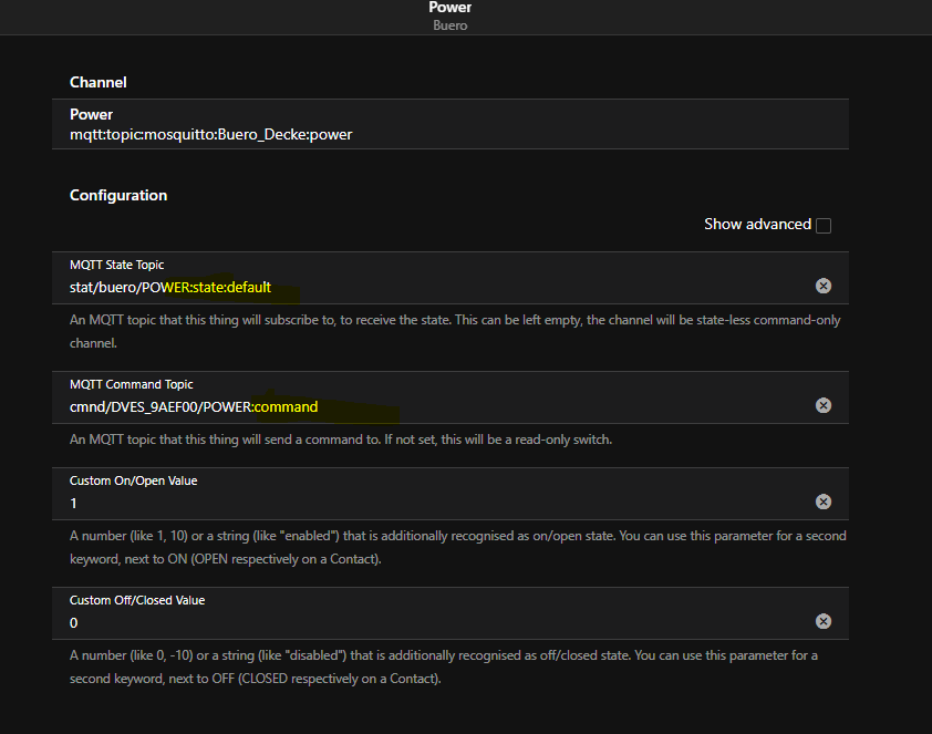

But while testing OH3 I found a possible Bug migrating the mqtt Things / Items.

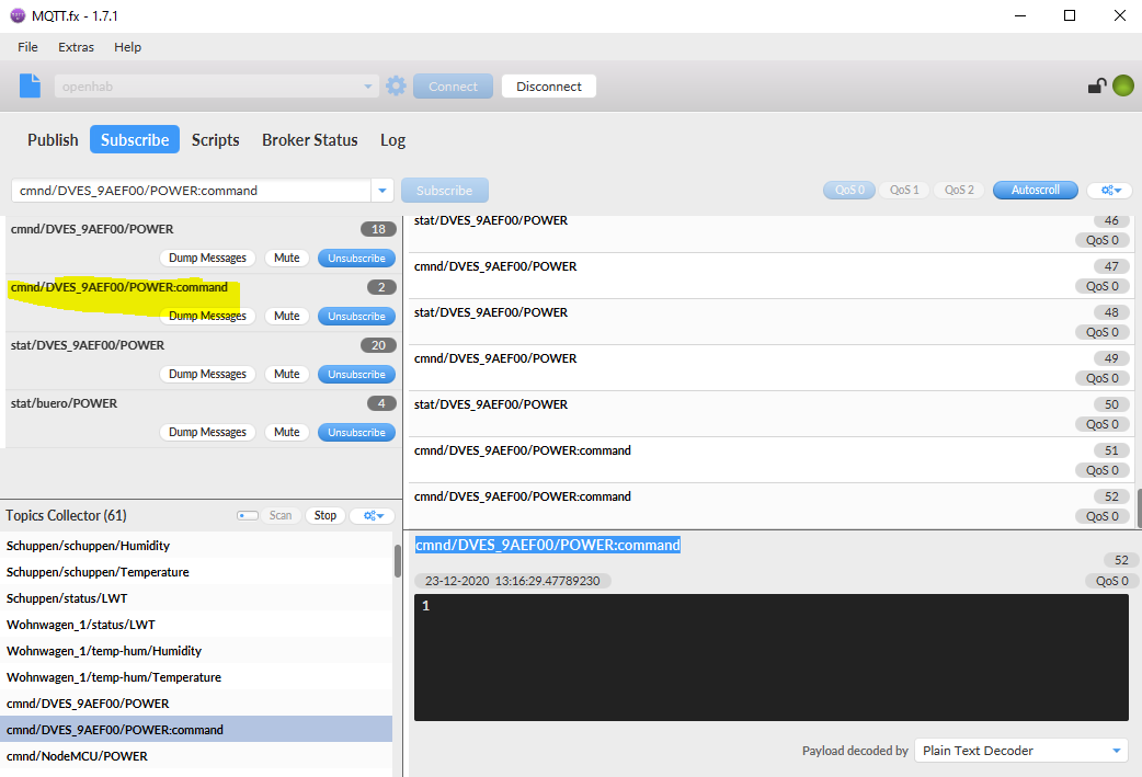

It sends a wrong mqtt command to the server.
(in OH2 with mqtt 2.55 it is working with the same config files)
First: It works if I configure the thing in UI but it does not work with config files:
Example:
mqtt.things File:
Bridge mqtt:broker:mosquitto “Mosquitto MQTT Broker” [ host=“192.168.250.20”, port=1883, secure=false, username=“test”, password="", clientID=“OpenHAB3” ]
Thing topic Buero_Decke “Buero” {
Channels:
Type switch : power “Power” [ stateTopic=“stat/buero/POWER”, commandTopic=“cmnd/DVES_9AEF00/POWER”, on=“ON”,off=“OFF”]
Thing topic schuppen “schuppen” @ “Another Room” {
Channels:
    Type number : temperature "Temperature"          [ stateTopic="Schuppen/schuppen/Temperature"]
it attaches: “:command” to the mqtt send
You can also see the wrong command in the UI:
