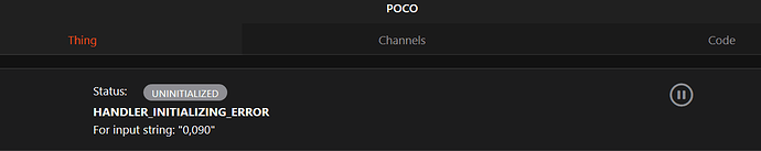

my network binding isn’t working anymore after upgrade to OH3…
I checked if there were any changes to the network binding, but everything seems to be ok with my configuration.
there are no errors or warnings regarding the network binding in my logs…
I made no changes to my files - and they’ve been working before upgrading.
how can I find out why the handler isn’t initializing??
For me it looks like a binding-related error, but I don’t know what the network binding is doing “under it’s hood”…
It should work this way but it doesn’t - I have no idea where to start debugging.
cheers
Edit: and maybe someone can confirm that there were no changes to the network binding configuration since OH3.x stable? And has anyone a working network binding with OH3? Just to sort out configuration specific problems…

IMHO the curious part is where this “0,090” string is coming from. Do you have anything like that in your files?
No nothing… I could imagine that this is something OS related while network binding is trying to bind to the OS-functions (arping) …but this is working fine when I try to ping without OH3… it’s a mystery - mainly or especially because there are no DEBUG infos from the logs…

I realized that everytime I manually Stop & Start the network thing, the number “0,xxx” changed to something between 0,078 and 0,143 so I thought this may be a pingtime in (milli)seconds - but I couldn’t imagine what could cause this…
but then I remembered the fact that my system locale was set to de-DE.utf8 and in Germany we seperate such numbers with a “,” not a “.”… and after changing the locale to en-US.utf8 voila my network thing is initializing and online…
