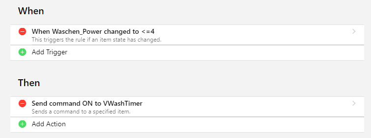

Your first attempt will not work. You can’t do math or comparisons in the rule triggers.
Your second attempt is going to be the way to implement this. I’ve not actually tried to do a comparison to a number state but the " " give me pause. Does it work if you remove the quotes around 4?
The second attempt seems to work, even with the "" .
The issue seems to be the trigger. In this case it could happen that the trigger item is not updated for a longer time even if the value is below 4.
Let’s assume the value remains at 3.5 for 1 hour, the rule is not triggered. On the other hand it can happen that it is constantly triggered since the item value is below 4 but varies…
