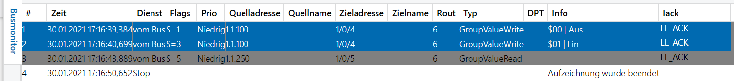

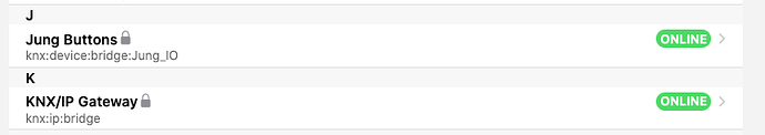

When I manipulate the KNX device (switch), I can see the correct ga´s being sent in ETS Group monitor, but I cannot get the items to update in OH. When I check the events.log it does not show any KNX activity, I have checked the openhab.log and both the bridge and the thing is loaded fine and online.
I must be doing something wrong, but I cannot figure out what. Any tips would be great.

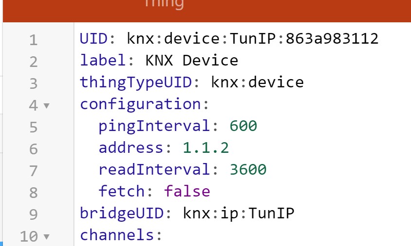

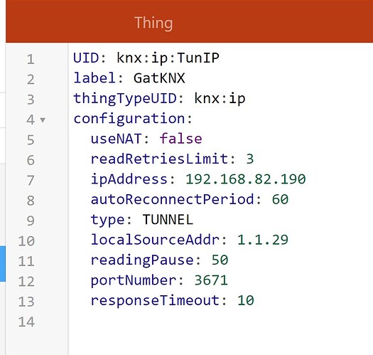

trying version 3 it doesn’t update the items when I act as a physical knx button.

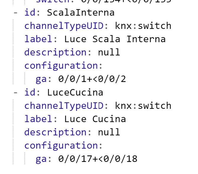

I set the GA adress: 0/0/0 [main] + <0/0/1 [state]
the only difference is that I configured everything from mainUI in 3, while in 2.5 I had the text files.
thanks,
yes yes 0/0/0 and 0/0/1 I used them only as an example …
what i don’t understand is why if i turn on the rpi with oh2.5 it works, while if i start that oh3, i can command but i don’t see the updates to the items

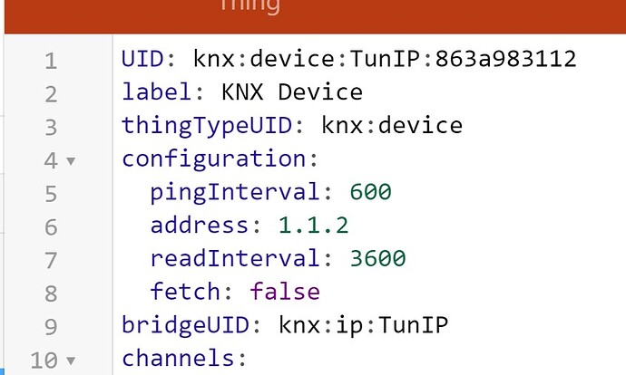

with text files everything works fine, and I read all the states and command everything. the “thing”, however, is offline.
I just wanted to say that some small bugs from 2.5 to 3 exist, because in 2.5 I never had any problems, and programming the channels on 3 from mainUI someone does not update as I said.
I have an IP port of the MDT and it supports 4 connections. on the KNX side I have no problem and on the bus with the ETS monitor I see everything.

It looks to me that you lack the ga for the status of the item.
The binding info could help you. I think you are missing the listening address.
