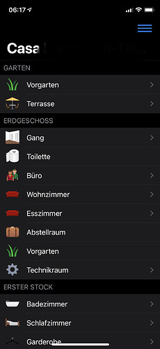

I use instead of http://openhabiandevice:8080/ the IP address of my Openhab Device - http://192.168.xxx.xxx:8080 and it works. But its not “the Basic Ui”
Also i did not select “Always send credentials” and have not entered any Username and PW. Still it works.

What worked for me was changing the local URL in the iOS app settings to http://192.168.xxx.xxx:8080/basicui
