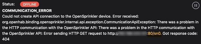

As the rework of http1 binding seems to be not finished I’ve tried opensprinkler binding to connect to my device once more. But the binding tells me that it is not able to access it.
COMMUNICATION_ERROR
Could not create API connection to the OpenSprinkler device. Error received: org.openhab.binding.opensprinkler.internal.api.exception.CommunicationApiException: There was a problem in the HTTP communication with the OpenSprinkler API: There was a problem in the HTTP communication with the OpenSprinkler API: Error sending HTTP GET request to http://X.X.X.X:80/sn0. Got response code: 404
while the address and the port is accessable in the browser and also using telnet to check the local network route.
/sn0 does not seem exist at least not in my OpenSprinkler setup but I don’t find where I could change this.

I had a quick look into the code base of the binding and I think it fails somewhere in the identification of OS version (OpenSprinklerApiFactory).

I had entered the hostname/address for my binding with a leading “http://” which should be okay. Ran into the same issue as you with GET “/sn0”. Removing the leading “http://” appears to have solved the issue.

I have not seen the binding send this yet, what causes this to get sent? How to reproduce?
EDIT:
try sending this and reporting back what it shows. This is used to work out the firmware version and I suspect yours is trying to use V1 firmware/api which does send sn0 which is not used in newer firmwares.
This is what I thought as well based on having a look into the code lines. But I don’t / didn’t get why the binding was not able to find / identify the correct version…
It would also be a good idea to try using the linux wget command to fetch this to ensure there is not a firewall issue stopping the request from reaching the binding. Its possible for another device to sucessfully work but a firewall rule to block the same call from the openhab machine.
EDIT: @smhaller what happens if you give the wrong password that is not hashed? Try this…
/jo?pw=wrong
It should still give you the same output and it wont give you the full data set unless the password is in the hash format.
If you enable TRACE logging on the binding do you get any clues? note the md5hash does not offer your password any protection so dont post any output after ?pw= in the URL’s that are logged. The latest version I uploaded has the logging removed so if you have the first version I uploaded it had a lot more log output in it.
