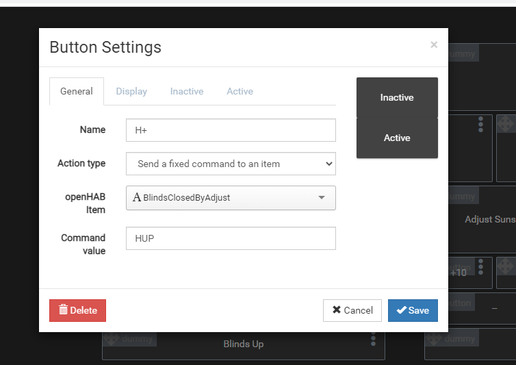

I have various items which are updated from HABPanel.

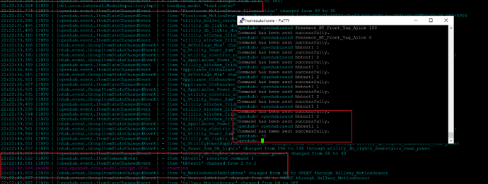

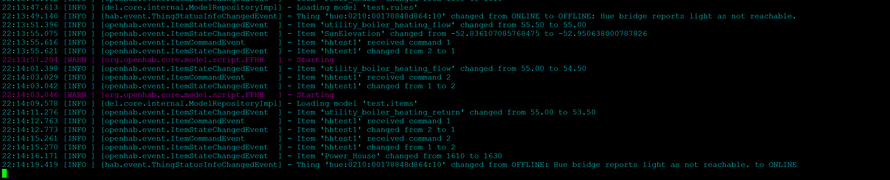

For this test I created files named test.items, test.rules and test.sitemap
Im running openhab 3.1.0~S2131-1 .deb
But something was fishy, and that is why I started tracking “unstable”
I have not changed anything of importance to my rules and items on this snapshot, so I can not tell if this is better or not.
