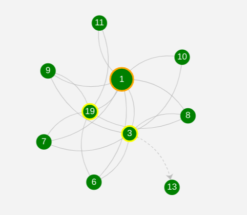

It seems like i`m experiencing “java heap space” errors after some time of running (about 2days) which crash my OH3 instance.
I have a debian VM inside a proxmox host and installed OH3 RC1-2.
It may have to do something with the zwave binding because the first abnormalities i can find in the log seem like a zwave controller reset.

2020-12-18 23:54:03.982 [INFO ] [ve.internal.protocol.ZWaveController] - Starting ZWave controller
2020-12-18 23:54:03.983 [INFO ] [ve.internal.protocol.ZWaveController] - ZWave timeout is set to 5000ms. Soft reset is false.
2020-12-18 23:54:14.422 [WARN ] [nal.protocol.ZWaveTransactionManager] - NODE 8: Not initialized (ie node unknown), ignoring message.
2020-12-18 23:54:14.423 [WARN ] [nal.protocol.ZWaveTransactionManager] - NODE 8: Not initialized (ie node unknown), ignoring message.
2020-12-18 23:54:15.351 [WARN ] [nal.protocol.ZWaveTransactionManager] - NODE 8: Not initialized (ie node unknown), ignoring message.
2020-12-18 23:54:29.554 [WARN ] [nal.protocol.ZWaveTransactionManager] - NODE 9: Not initialized (ie node unknown), ignoring message.
2020-12-18 23:54:31.396 [WARN ] [nal.protocol.ZWaveTransactionManager] - NODE 9: Not initialized (ie node unknown), ignoring message.
2020-12-18 23:54:32.303 [WARN ] [nal.protocol.ZWaveTransactionManager] - NODE 9: Not initialized (ie node unknown), ignoring message.
2020-12-18 23:54:35.994 [WARN ] [nal.protocol.ZWaveTransactionManager] - NODE 9: Not initialized (ie node unknown), ignoring message.
2020-12-18 23:54:52.029 [WARN ] [nal.protocol.ZWaveTransactionManager] - NODE 7: Not initialized (ie node unknown), ignoring message.
2020-12-18 23:54:52.032 [WARN ] [nal.protocol.ZWaveTransactionManager] - NODE 7: Not initialized (ie node unknown), ignoring message.
2020-12-18 23:55:21.480 [WARN ] [nal.protocol.ZWaveTransactionManager] - NODE 7: Not initialized (ie node unknown), ignoring message.
2020-12-18 23:55:21.481 [WARN ] [nal.protocol.ZWaveTransactionManager] - NODE 7: Not initialized (ie node unknown), ignoring message.
2020-12-18 23:55:47.794 [WARN ] [nal.protocol.ZWaveTransactionManager] - NODE 6: Not initialized (ie node unknown), ignoring message.
2020-12-18 23:55:49.742 [WARN ] [nal.protocol.ZWaveTransactionManager] - NODE 6: Not initialized (ie node unknown), ignoring message.
2020-12-19 00:03:46.960 [WARN ] [mmon.WrappedScheduledExecutorService] - Scheduled runnable ended with an exception:
