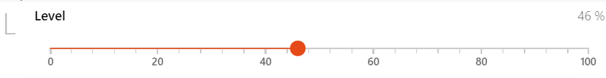

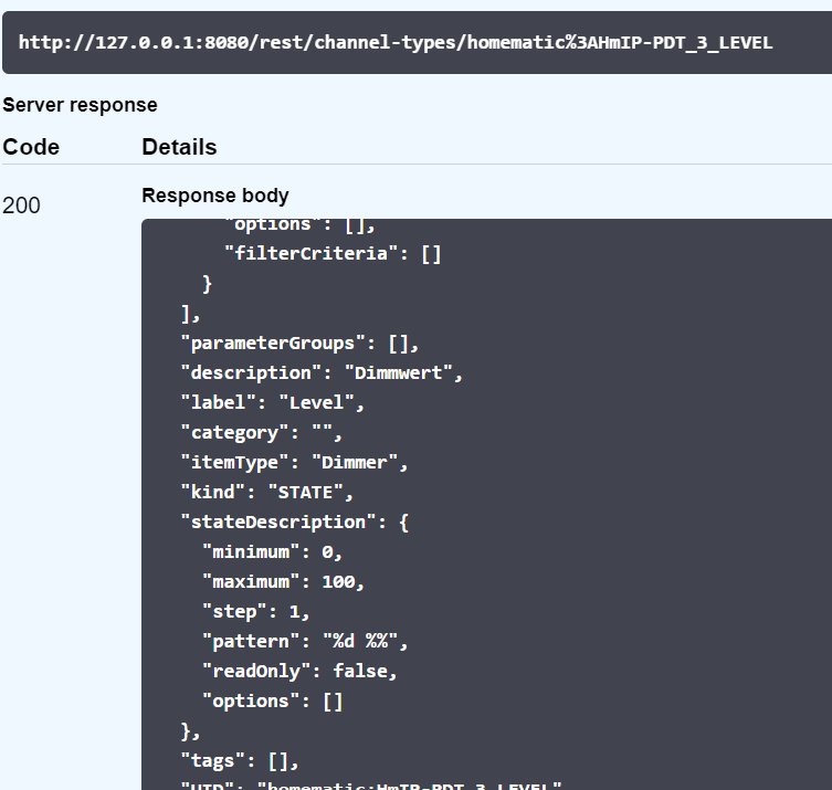

The Homematic binding creates all thing and channel definitions dynamically. For a dimmer there is a channel-type “LEVEL”. This channel-type contains several entries as you can see here:
The entries are correctly considered e.g. in he equipment display:

I would have expected that here the default values from the channel-type definition were visible.
