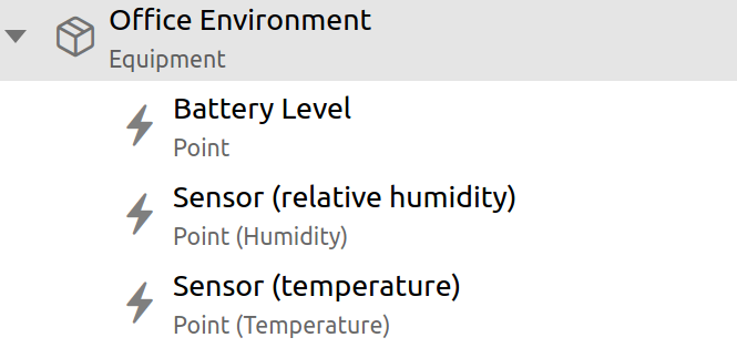

I have set the sensor items up to have the correct semantic types, I think. Like so.

There really is no “correct” types. However, I think “Measurement (Humidity)” and “Measurement (Temperature)” would be more meaningful since that is what those Items represent. Conversely, if you had a setpoint for a heater, I’d use “Setpoint (Temperature)”. There really isn’t a great pair of tags for battery levels. I tend to use “lowBattery (Power)” for mine. But this isn’t about correct and incorrect. It’s about providing meaning in the model.
