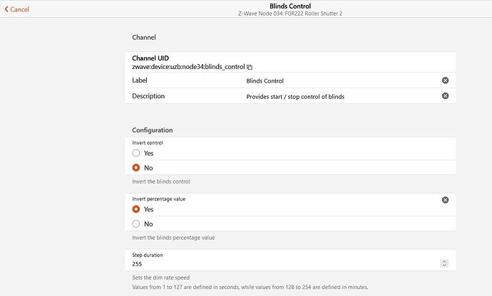

I’ve a few Rollershutter and 2 of them are inverted with the commands.
In openhab2 I solved that always via paper ui where I could simply invert the command (and also value percentage)
Where can I find this is Openhab3?

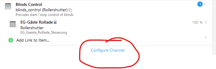

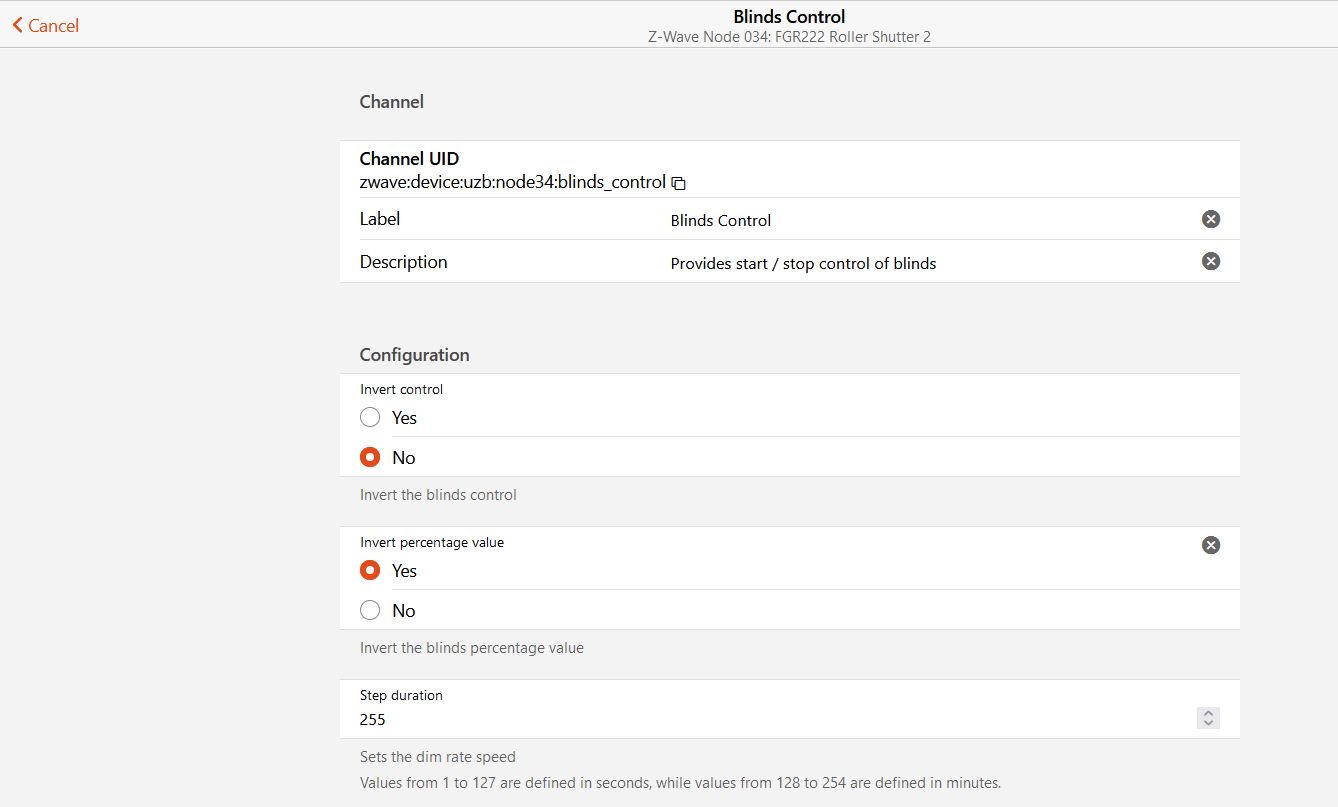

Thx, I found the link now to configure the channel
seems I´m stupid as I dont find the “configuration setting of the channel”.
Please kindly advise.
UPDATE: found it via Things->> Channels–>Configure Channel
