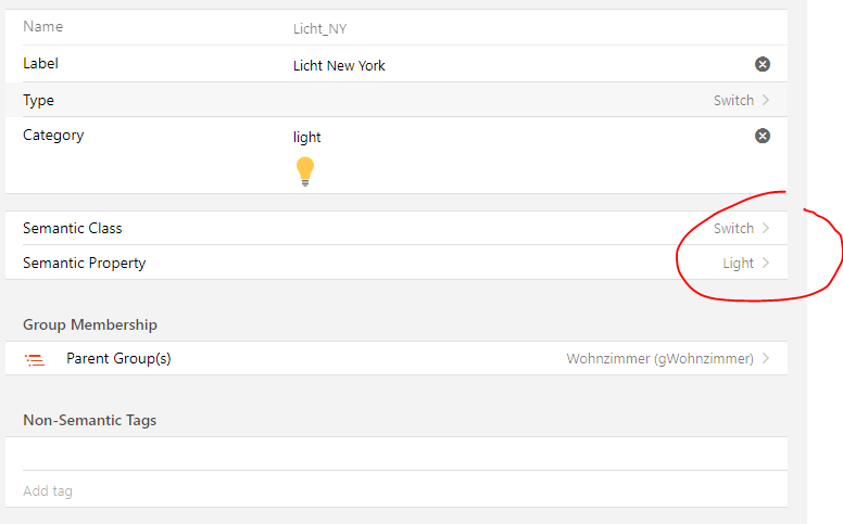

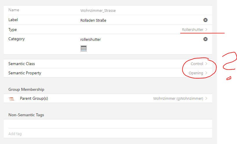

@rlkoshak Thanks for the detailed explanation! But I still have a specific question. For the Light item, I use the semantic values Class → “Switch” and Property → “Light”. See screenshot 1. For the Rollershutter I use which ones for Class and Property? For semantic class there is no “Blind” value available. See screenshot 2. When I select “Blinds” I have an equipment and no point object anymore. But from my point of view a Rollershutter is a Point or am I wrong?
It depends. Typically an Equipment would be a Group and all of the Items associated with that Equipment would be members of that Group. But if you only have one Item to represent the Equipment it’s perfectly reasonable to just have the one Equipment Item without creating the Group.
So unless you have other Items that are a part of the RollerShutter, I’d just label it as the Equipment and be done.
You are not going to see a Point tag that represents a RollerShutter because Points are intended to be a part of something bigger. So you might have an Equipment Group that is tagged with “Blinds”. That equipment might have as members a RollerShutter Item which I’d tag as a Controll, or Switch or something. I don’t think there is a property that makes sense. It might also have a battery level Item that works be tagged with something like Status as the point and power as the property.
