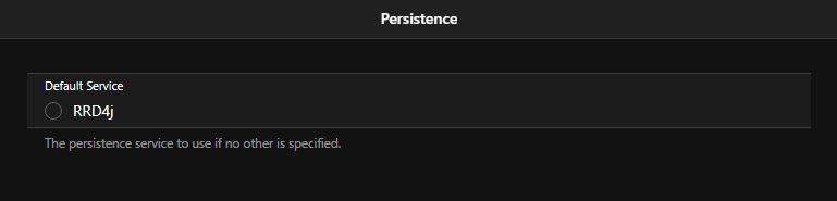

And rrd4j
is selected as default on the UI:
