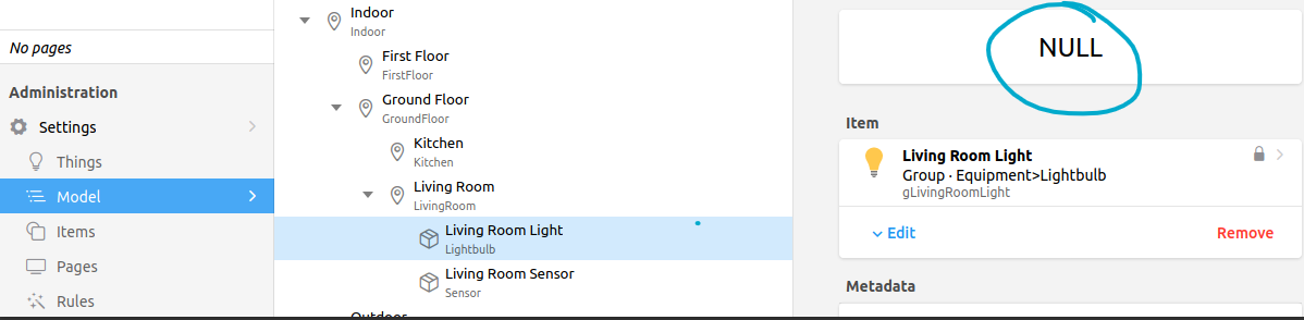

I am having one particular problem, I do not understand. I have an LED stripe, which I would like to show up as a “Light” under Properties, and as a “LightStripe” under Equipment. I am using this syntax here:
The problem is that when I put both “LightStripe” and “Light” then it seems to ignore the “Light” tag: in the UI, the item shows up under Equipment but not under Properties. When I remove “LightStripe”, then it is shown under Properties but not under Equipment. What am I missing? Do they conflict in some way?
I see. But why is that? I understand that no item should be at multiple locations at once, but what’s wrong with an item being at a certain location and also resembling some equipment?
Items can only be a point of one equipment in the semantic model, but be members of multiple non semantic groups, So you can have it in a semantic equipment group and a non semantic at the same time.
The semantic model is intended to and built around representing the physical layout of your home automation. No Equipment can physically be in two locations at the same time. No Point (i.e. sensor or actuator) can be in two locations at the same time nor part of two Equipment at the same time. Once you head down that path you are no longer representing the physical layout of your automation.
But as @hmerk indicates, you can model your home automation in other ways (e.g. functionally, involvement in scenes, etc.). You just need to make that model be outside the semantic model.
