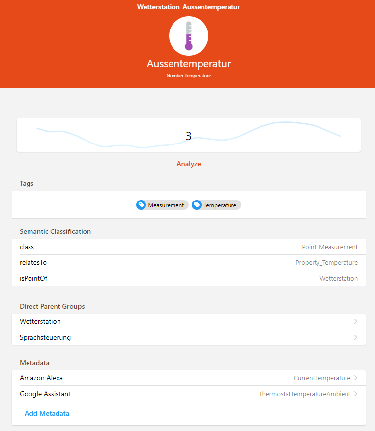

Some temperature-sensors are displayed correctly with units - some are without units and this one is displayed with unit in list-view and rounded without unit in cell-view:
Where is this behaviour configured?

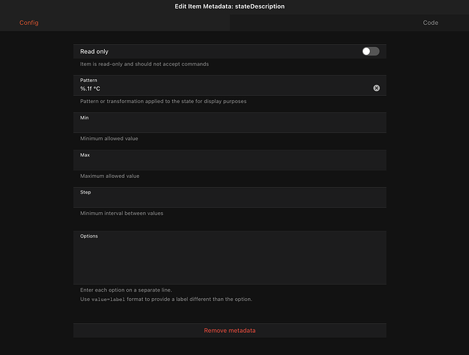

Metadata → Set State Pattern
I understand that the unit is automatically displayed if the type is set correctly.
You need to add pattern in state description.
%.1f °C

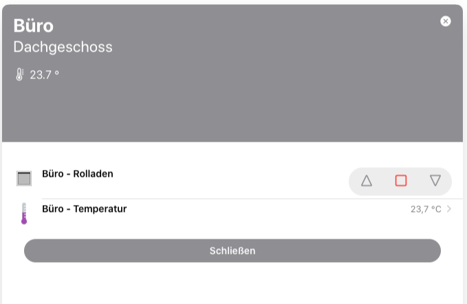

Do we really have to set the %.1f °C to every KNX temperature item? By the way this leads to different outputs. KNX does output e.g. 23,2°C and an automatically formatted item does show 23.2°C.
Is there a nice solution for that? This is quite messy. :slight_smile:
