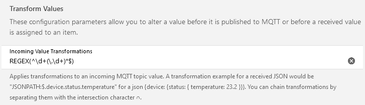

So - I tried to REGEX (^\d+(\.\d+)*$) this in “incoming value transformation” like this:
I think I need more clarity. What is the format of the messages coming in and what do you want it to be published as?
My understanding was you are receiving 21.5 °C and need to publish 21.5 °C.
I’d try a simpler REGEX (make sure you’ve got the add-on installed of course). Also, your formatting is wrong. REGEX:(.*) °C. Notice the : instead of wrapping the expression in (). All transformations in MQTT and HTTP follow that sort of format: TRANSFORM_NAME:EXPRESSION. That REGEX assumes there is a single space between the number and the °C.

I’m not sure how either of those REGEX would work. In OH REGEX transformations, the expression must match the full String, not just the part you want. Neither of those expressions match the full String. That would explain why the first one doesn’t work but I’ve no idea how the second one could work at all.
The .*? construction is a little off too. The . means any character. The * means zero or more matches. The ? means zero or one matches. But matches of what? Does that mean zero or one matches of zero or more matches of any characters?
Assuming you meant one or more using your same overall approach it would look something like:
(.+) °C
The + means one or more. Adding the C ensures the expression matches the full String. If you want to me really thorough you can add a .* after the C in case there are newlines or something like that that need to be matched.
