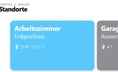

Number:Temperature  radiator_valve_01_Set    "Thermostat Büro Richtwert [%.1f %unit%]"   <heating1>        (gRFritz_01,gRtSoll)     ["Setpoint","Property_Temperature" ]    { channel="avmfritz:Comet_DECT:192_168_178_1:119601003400:set_temp" }
Number:Temperature  radiator_valve_01_Temp   "Thermostat Büro Temperatur [%.1f %unit%]"  <temperature>     (gRFritz_01,gRtIstI)     ["Temperature","Measurement"]           { channel="avmfritz:Comet_DECT:192_168_178_1:119601003400:temperature" }
First item is the Setpoint of the temperature (Sollwert, Richtwert → 21,5 °) and the second item is the Temperature-item (21,8 °) which should be measured and shows me:
