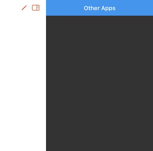

I created my sitemap via the “old” config file. It was working fine with OH2. With OH 3 I can see it on my iPhone but it does not appear in the basic UI view as described here:
Accessing the sitemap via REST API (http://192.168.1.199:8080/rest/sitemaps/myhome) works fine. What do I need to do to see it in the UI as well?
Check that Basic UI is installed.
