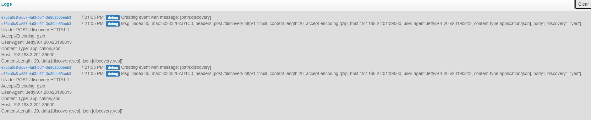

Hi - I am using a new 3.1 (Windows 10) fresh install of OH3.1. Completed ST Device/Handers configuration and copied your .jar to the
“C:\Program Files\PRODOpenHAB\userdata\tmp\mvn\org\openhab\addons\bundles\org.openhab.binding.smartthings\3.1.0-SNAPSHOT”
directory but still no luck. Using the ST Dev “Live Logging” I can see the request but not getting anything back in OH when I SCAN. Live Logging Below:
e75ba0c8-a557-4af3-b6f1-3e80ab65eeb3 9:06:11 AM: debug Creating event with message: [path:discovery]
e75ba0c8-a557-4af3-b6f1-3e80ab65eeb3 9:06:11 AM: debug Msg ‘[index:A4, mac:302432EAD1C0, headers:[post /discovery http/1.1:null, content-length:20, accept-encoding:gzip, host:192.168.2.201:39500, user-agent:Jetty/9.4.20.v20190813, content-type:application/json], body:{“discovery”: “yes”}, header:POST /discovery HTTP/1.1
Accept-Encoding: gzip
User-Agent: Jetty/9.4.20.v20190813
Content-Type: application/json
Host: 192.168.2.201:39500
Content-Length: 20, data:[discovery:yes], json:[discovery:yes]]’
Any Thoughts? The area I am not 100% confident, being a noob to this, is the .jar file. When I go to the addons dir above it has several files created from the bindings. so it is not a direct file replace. I really appreciate your time and efforts on this.
I have the same issue. I am un ubuntu. JAR file added to /usr/share/openhab/addons/. The binding does not show up in settings but is there when you add a thing. I also noticed an update to the smartapp so I updated the IDE. Even tried removing the smartapp and re-adding it but no luck.
It looks like the discovery request is being sent but no data is being returned. In the Smartthings Installation document did you complete the Configuration in the smartthings app? If not that is most likely your issue.
