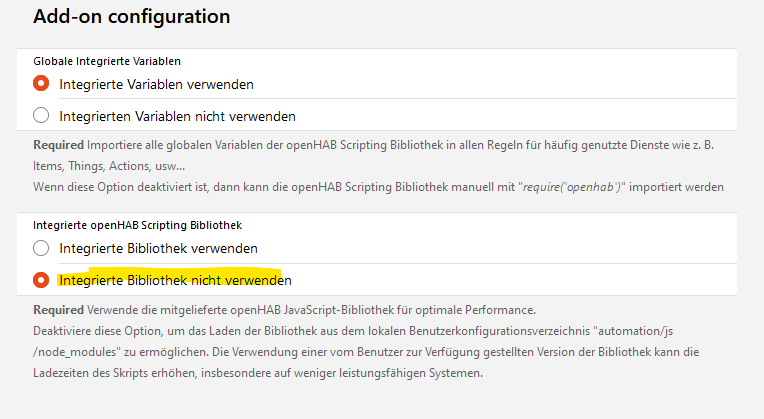

How can I disable the caching?

It’s the second options in the addon settings.

Do you mean this option?
This does not really make any difference in compilation time.

Yes exactly.
Hmm, that‘s not as it should be. Caching should speed up the compilation time (at least once any JS code has been compiled and the „cache“ is initialised) compared to non-caching. I really wonder why on some RPis it has significant effects, but on others nearly no effect.
