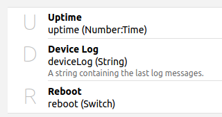

I’ve succesfully installed and configured the TR-064 binding (the thing is online) but all I can see are these 3 channels
Is that normal for the actual development state of the binding?

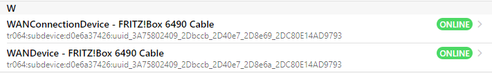

Other channel are conncted to the virtual devices. Please do a rescan for this binding and you will see those virtual devices in your inbox.
Thank you very much!
Maybe a stupid question, but for me a re-scan ist unable too find any sub-device beside thsese two guys:
The documentation ist talking about subdevice and subdeviceLan:

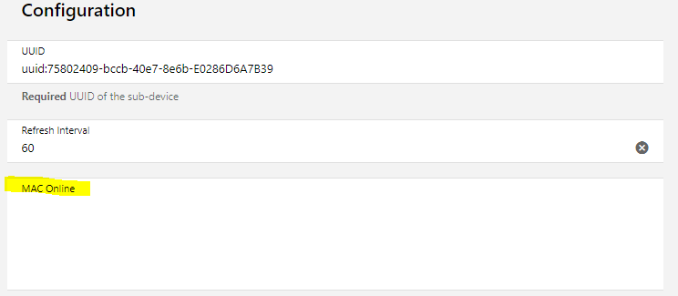

For subdeviceLan devices (type is detected automatically during discovery) the parameter macOnline can be defined. It adds a channel for each MAC (format 11:11:11:11:11:11) that shows the online status of the respective device. This is an optional parameter and multiple values are allowed.
Since I want too use mobile phones for presence detection I wonder, how to set it up? I tried it already within the manual way, but fail on specifying the UUID.

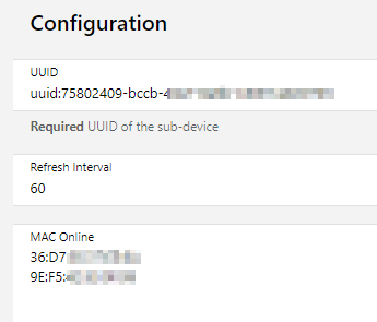

You should automatically see a LANDevice - FRITZ!Box 6490 Cable with the following config options:

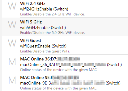

Thanks for the hint, found the LANdevice, added two MAC adresses:
and in channels I can see the two switches, I was looking for.
Thank you very much, appreciate it.
