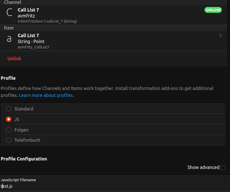

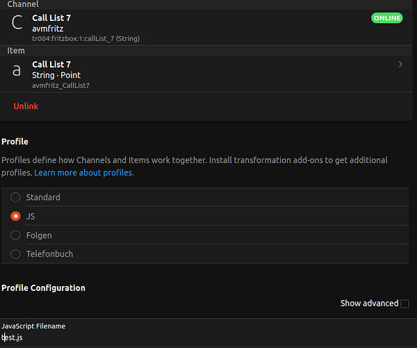

Add the JavaScript Transformation to the channel and transform the value in a .js.
I’ve done a little research and think adding the JavaScript transform is done as shown. The file is then saved under ../transform. I still have a problem with formulating the .js file. There are certainly differences for date and time or “callerNumber” and “calledNumber”.
