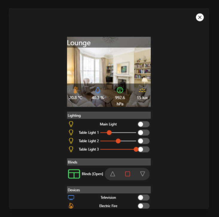

I’ve finally started playing with the new OH UI and have created my first widget.
It’s not perfect, but will do as a start.
However, I’m having issues getting it to size correctly and/or popup/popover.
My widget:
However, trying to put it on the overview page only works if the new widget is added directly.
What I want is to have it as a component of the cell or popup or popover, but I get the following issues:
I’m presuming there are some (un)documented settings somewhere to fix this (probably “style:”), but everything i’ve tried has literally made no difference.

I’ve got it working a bit better with some css style settings, but it looks totally crap on a phone.
However, as I can still use BasicUI I can use the Android app.
Initially this new UI is going to replace my OpenHab UI, which looks even worse on my phone.
I’d prefer to get it looking right on both, but I suspect the limitations of the OH UI and Framework7 will mean I can’t have both.

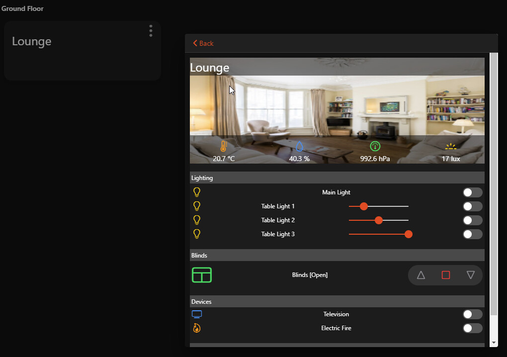

I think for your goal, it would be a better way, creating 2 widgets with different base-components. I think you’ve used either a f7-block or a f7-card here?!, which will get messed up in a popup very quick.
For the use in a popup I would recommend you, using the f7-page as a base component, which uses the full width and height, without applying extra styling.
The card is made up of a summary and details cards.
YAML below (as stated earlier, the only caveat is that it looks crap on a phone and is only tested on Chrome atm)

I’ve made two widgets from your yaml - is the idea the summary card is on a page then clicking it the whole thing appears? At the moment the summary shows but the pop up just greys out the page like something modal is supposed to show
