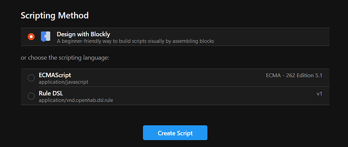

There are four supported languages (five if you count Blockly) and they can each be used either through the UI or by writing them in text files. So which language are you trying to use and how are you trying to use it.
A couple of notes, you have to install addons for Python or Groovy support. Rules DSL and JavaScript/Blockly are supported out of the box. The Helper Libraries don’t work yet unless you pull from one of the PRs that have been submitted but not yet approved to update them for OH 3 support.

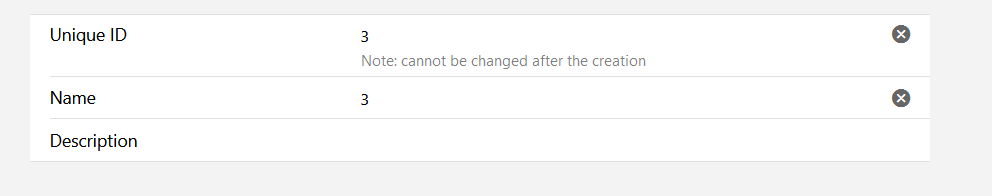

Just curious, did you specify a name for your rule/script? OH tries to save the rule/script before opening the editor. And saving fails if the name is empty.
i can’t create an new rule - when i press the “create script” Button, the nothing happens.
