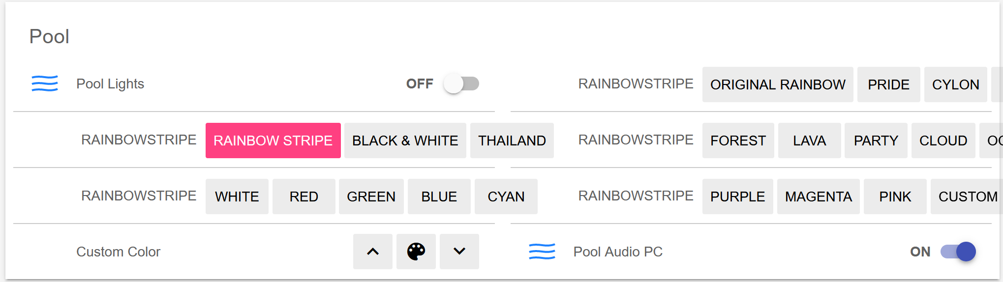

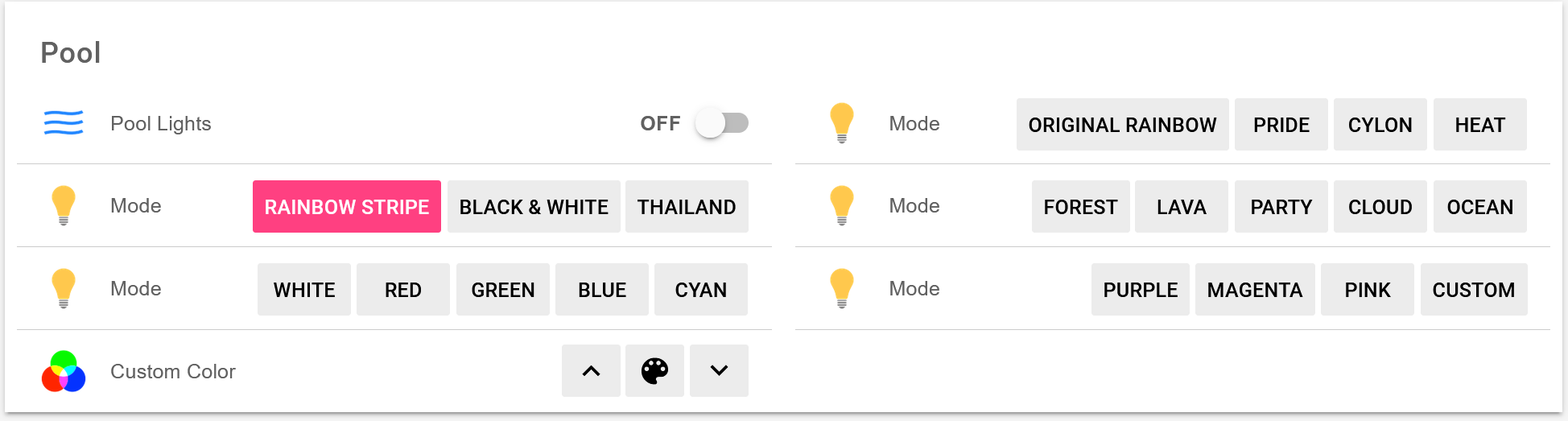

In OH2.5 BasicUI it shows up like this:

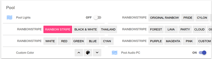

But, in OH3 BasicUI it shows up like this:
The current string is being displayed, even though [%s] is not part of the label definition!
How do I make it not do that?
