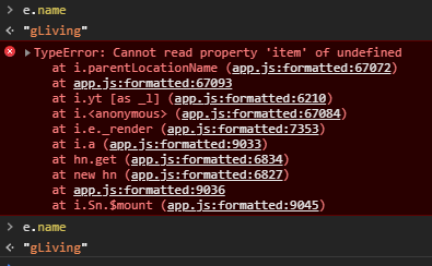

Yes you can click the first line on the stack trace of the error that you get. (with app.js pretty printed as you’ve already done).
Next you right click on the line number (67072), select “Conditional breakpoint” in the menu, and type !t
as the expression.
then hit Return, the line number should highlight in yellow.
Then go to another tab in the app and go back to Locations, it should pause at the breakpoint before the error occurs. Then in the console you just have to type e.name and there’s your culprit:
Don’t forget to remove the breakpoint afterwards to avoid headaches.

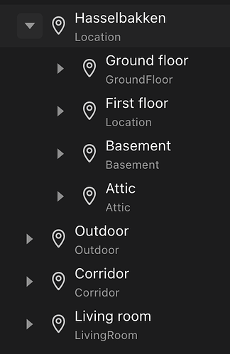

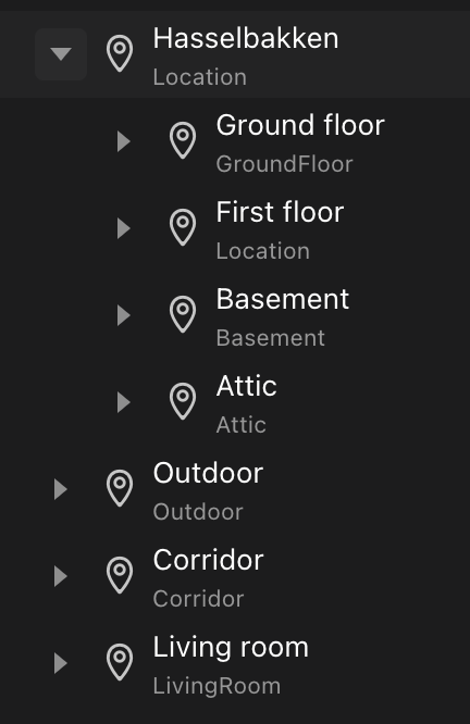

I got the cards on Locations back by disconnecting all 1. level sublocations from the top location. Adding one and one back it seems to fail on several of my “sublocations” when I add them one by one back in the hierarchy.
Given this model setup the Location tab works fine:
So Livingroom, Corridor and Outdoor seems to be failing.
Looking at livingroom separately I just don’t get how it is working as a “top level” location and not as a sublocation of another.
Having LivingRoom as a root node works fine, putting it below another node seems to be failing.
Here I used the restapi to query it while failing and below the Hasselbakken -> FirstFloor node.

The Locations tab will break if a part of the model is tagged directly with Location and not a subclass of Location. Switching it to e.g Indoor will fix it.
