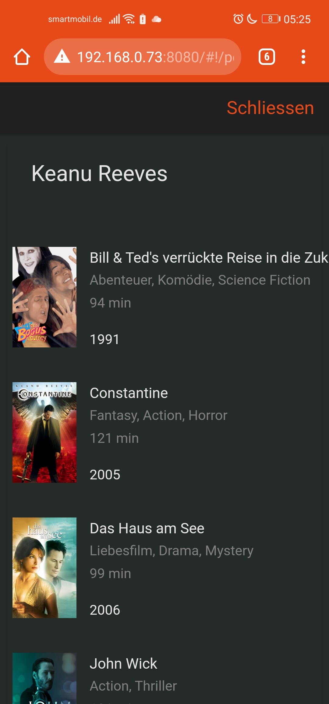

@RGroll
is it possible to have a scrollbar?
or that he scrolls the popup when the entries are longer than the page?
now i see the last icon not because its to long:

they should appear automatically, if you swipe up content. but this requires to delete the button inside the popup code. remeber to set tabletFullscreen: false

i have the tabletFullscreen:false in my popup, but i had no scrollbar and the last cover is still cut off like in my picture above.
here is my code perhaps you find a problem ?!
but be careful, thatâs a lot of code

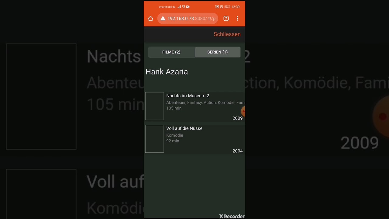

(marc schlĂŒter)
April 8, 2021, 7:13pm
30
Here you can See what i made with the help from you All.
