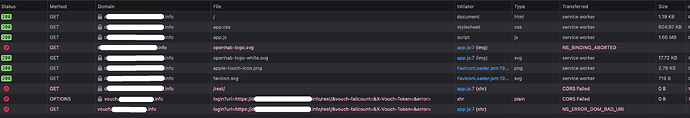

In this case, when I try to go back to OH, I can only see a blank page (black in my case as I use the dark theme).
Here is what can be observed in the dev tools:
The problem is the same no matter what web browser is used (tried with Brave, Chrome, FF).
If I force reload the page, it works.
