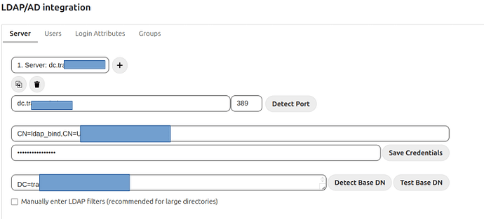

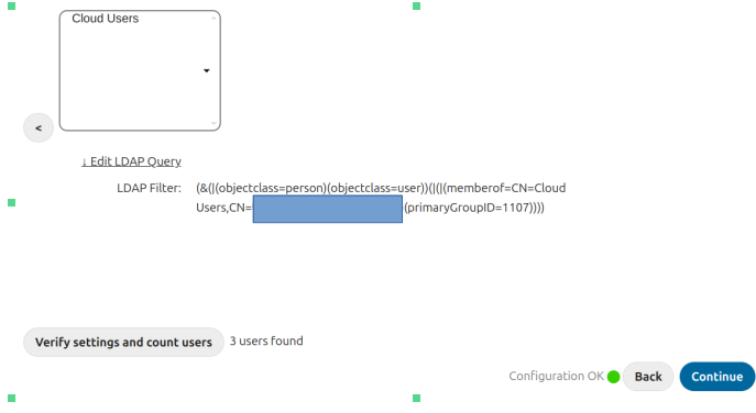

I am thinking more of LDAP support within openhab like for example nextcloud ( https://nextcloud.com/ ):
