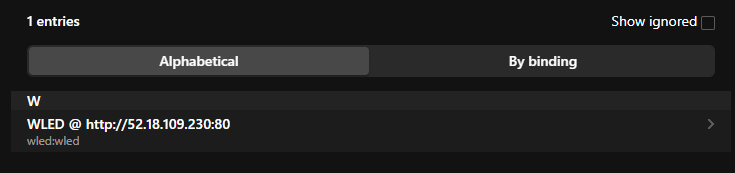

No Not using textual config. I have been using the milestones and previous version of wled without issue until WLED was added then I removed the previous version from the addons folder and this entry turned up. Can’t remove it or ignore it, but it is also not causing any issues apart from showing in the inbox
Then that explains it for you. During the review and merge process the binding was changed to detect and only show one entry for a MAC address wled. If you added thing with an older binding it would not have the MAC address stored in the thing. If you delete and re add the thing that should fix it.
I stopped following the migration path as I had many, many various problems. Now I’m setting up a fresh, clean OH3.0 instance and the error is gone. Thanks!
I have OH3 installed and Wled latest version 13 installed, and i have this very issue. The mailbox has WLED@192.168.1.191:80 and it will not let me add it, or delete it or ignore it. If i manually add the thing it does not work, when i try and add it to my model under create equipment from thing it won’t let me check it in the list that pops up. The device is on the network but i cannot added it to oh3 and its stuck with this constant in the inbox
