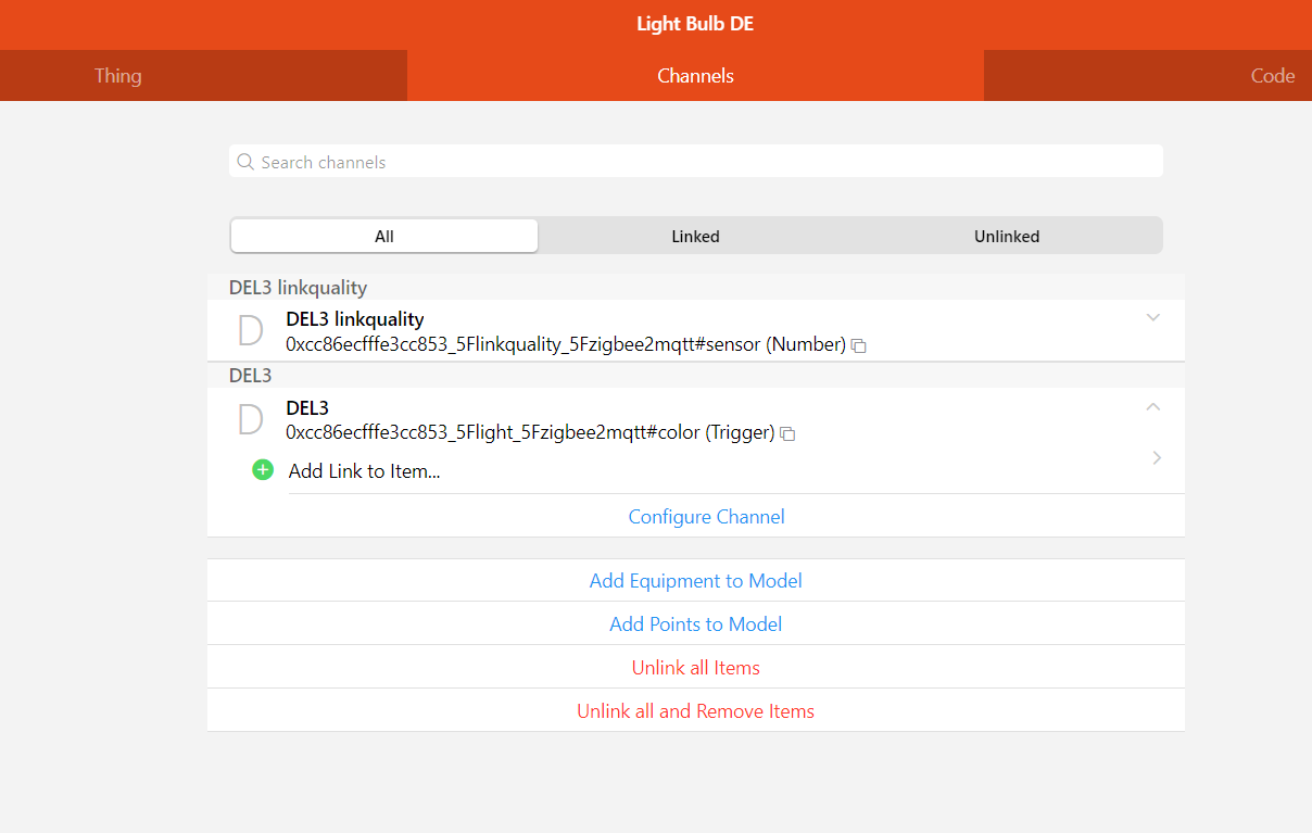

Not even sure, how the trigger channel would actually do all the switching, dimming and color changing, as creating the Itemfirst and the trying to link it back to the trigger channel, doesn’t work neither.
Hi I’ve just seen your post, so you may have resolved the problem by now. However just in case I got the Lidl’s bulbs to work by configuring them as Generic MQTT Things (first ensuring that the MQTT Version was set to 5) and creating 3 Channels: OnOFF; Brightness; and Color_Temp The configuration of these channels is a follows:
