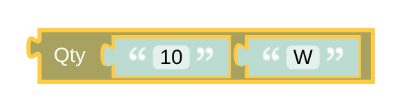

After going through this again, I can now tell you more clearly what kind of “shocked” me that much, that I wrote the posts above. In the end, it was only a single line of the Blockly code. This one:
grafik
Because this looks like the quantity of the item “ItemPower” is added with a STRING (the blockly block shows the two quotes) containing “10” and “W”. This was against all I ever learned as a computer scientist (which I am, but not working as a programmer any more). What happens if I write “10 w”, “10w”, “10 watts”, “10 watt” into this field? That’s looks very ambigous to me.
If the line had looked like this:
grafik
I never would have had any doubts about using quantities. Because in this case, the value and the unit are exactly defined and not an arbitrary string.
In the end, that’s all :slight_smile: I don’t know how the original field is handled, maybe it works like this already.
So again, apologies for starting this side-discussion.
Have a nice evening,
Melvin
That’s just one of the options. There is also a block to build the Qty with the number and the units as separate arguments.
The Qty block activates a builder. Its whole job is to parse what ever it’s passed into a Quantity Object.
You can use a String representation of the the number, a Java Number, and openHAB DecimalType, or a JavaScript Number for the first argument.
Sometimes it’s more convenient to provide it all as one String, sometimes as separate arguments
The units that are supported are documented at Units Of Measurement | openHAB and specific features unique to JS Scripting are documented at JavaScript Scripting - Automation | openHAB. Because Blockly converts to JS Sripting in OH 4 both links are relevant.
As long as the units are valid (I think the Ws need to be capitalized) all of those should work, following the old computer science Robustness principal. Be conservative in what you produce (internal to OH the value will always be 10 W) and be liberal in what you accept.
Unfortunately there is no way for Blockly to know all the Units to generate a list to choose from. It gets even more complicated when you apply quantity qualifiers. For example, MW (megawatt) and kW (kilowatt) are also valid units. That list of units will become huge to list them all. And we still probably wouldn’t get it right as some units can be combined on the fly. For example Bq/m³ uses four different modifiers. The Becquerel unit for radioactivity. The / to indicate “per”. m to represent Meters and the 3 to indicate volume. But these are all combined to represent the radioactivity density reading (it’s a radon sensor).
From an end user perspective, accepting the units as a String is probably the best we can offer short of creating a whole new UI “unit builder” which would be cool but I wonder if effort were not better spent elsewhere.

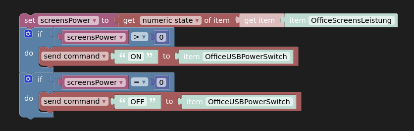

Thanks for this hint. But at the moment my openhab isn’t working with many scripts, 'cause before update to 4.0 UoM Items where not really easy to handle. Now my trick isn’t working and i must rebuild the code. At the moment Openhab 4.0.1 runs with many issues very bad and i try at first to fix scripts easy as possible. And that helped me at the moment:
To get the numeric state of item.
Why are you working with the normal comparison block instead the the blockly Quantity Comparison when comparing the Leistung (Power) here?
How does it work with 3.4? The same?
Blockly doesn’t support UOM in 3.4 - this was a major improvement for 4.0. I thought you were on 4.0.1 already?
Yes exactly and openhab isn’t running well after 4.0 upgrade. It’s all bad i must fix all my script and then if i have more time i can improve it. But at this point, it doesn’t help me to recreate a complete rule! So step by step! I sit here since 7h with a system that crash every time with many errors and I do my best. But optimizing is very low in my agenda.
If you are on OH 4.0.1 I see nothing wrong with the blockly code you’ve posted here. Whether OfficeScreensLeistung has a unit or not, screenPower will be just the number without units.
I think our point is this isn’t about optimizing the code. It’s about reducing the amount of work you need to do. Once again, if you don’t care about the units, get rid of the units by changing the types of your Items to just be Numbers. If you do care about units, it’s no more work to modify your rules to use the units than it is to modify your rules to strip off the units. In fact, it’s more work for you to strip off the units in many cases and exactly double the work if you want to go back and add in the use of units later.
All you’d need to change to the blocks you show above is “get quantity state of itme” and use the Quantity Comparison block in your if statements. Same amount of work, just a different selection of blocks.
Yes I know it. I post a possible solution. That’s all.
