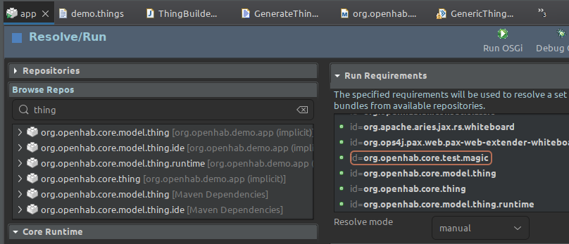

I added magic addon to test changes I’m trying to introduce in org.openhab.core.model.thing and org.openhab.core.thing bundles (as well as org.openhab.core.model.thing.runtime). I have added these bundles in the org.openhab.demo.app pom.xml :
Try the Magic Binding bundle in the Marketplace instead.
The issue with the one in openhab-core is that the bundle name is not standard like all other add-ons. I already anticipated this issue when implementing:
I think the best fix would be to move the Magic Binding to openhab-addons and give it a proper bundle name.
While I am not working on OH core I find above way (standalone instance) quickest to get started with and closest to “common way”. IDE support makes things faster, but sometimes breaking for unclear reasons.
