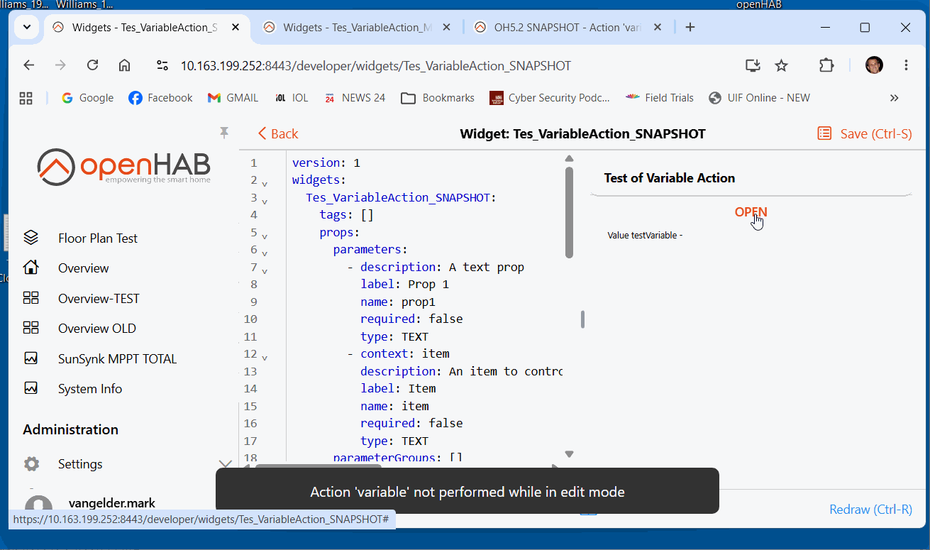

Hi All
I have just updated to: openHAB 5.2.0 Build #5391 - Todays SNAPSHOT
I have not edited a widget for some time, but wanted to make a change today and end up with the error:
This a happens when I try AND use the widget.
A sample (minimised code) is:

This happens using Developer Tools/Widgets.
Never had to use a run mode before, and don’t see how thsi is done either?
Can anyone help please?

However when using SNAPSHOT:
Test Widget SNAPSHOT
version: 1
widgets:
  Tes_VariableAction_SNAPSHOT:
    tags: []
    props:
      parameters:
        - description: A text prop
          label: Prop 1
          required: false
          type: TEXT
        - context: item
          description: An item to control
          label: Item
          required: false
          type: TEXT
      parameterGroups: []
    component: f7-card
      title: Test of Variable Action
      footer: =props.prop1
      default:
        - component: f7-block
            style:
              top: 45px
              left: 0px
              margin: 0
              padding: 0
              position: absolute
              width: 100%
            default:
              - component: oh-button
                  action: variable
                  actionVariable: testVariable
                  actionVariableValue: '=(vars.testVariable == "null") ? true : !(vars.testVariable)'
                  style:
                    height: 100%
                    width: 100%
                  text: OPEN
        - component: Label
            style:
              color: black
              font-size: 10px
              left: 20px
              position: absolute
              top: 78px
            text: ="Value testVariable - " + [vars.testVariable]
Hope this help narow down the issue?
Mark

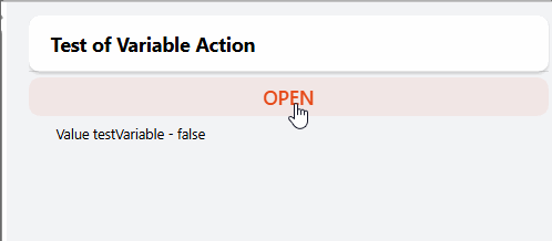

That’s likely a regression from my widget actions refactoring. I think I have DRY-ied the edit mode check and thus variable actions are also disabled in edit mode.
The message pretty exactly described what’s the issue. In case the item name there is constructed from a variable and a string, that is a consequence of the above.
Thank you. Yes, the item name is contructed from the variable. Apprerciate the feedback. Atl least I know you are on it. Theer shoudl hoqwever be quite a few of these as there are many items constructed from the variable.
So the root cause was different than I expected, it was not my refactoring that led to this regression.
I’ve created a fix for the variable issue (the issue actually affects all widget actions):
Thank you so much for the quick turn aound
Unfortunately it’s too later for M5, which was released today (but built last night). M6 will be released in three weeks.
Thank you. All up and working again :slight_smile:
