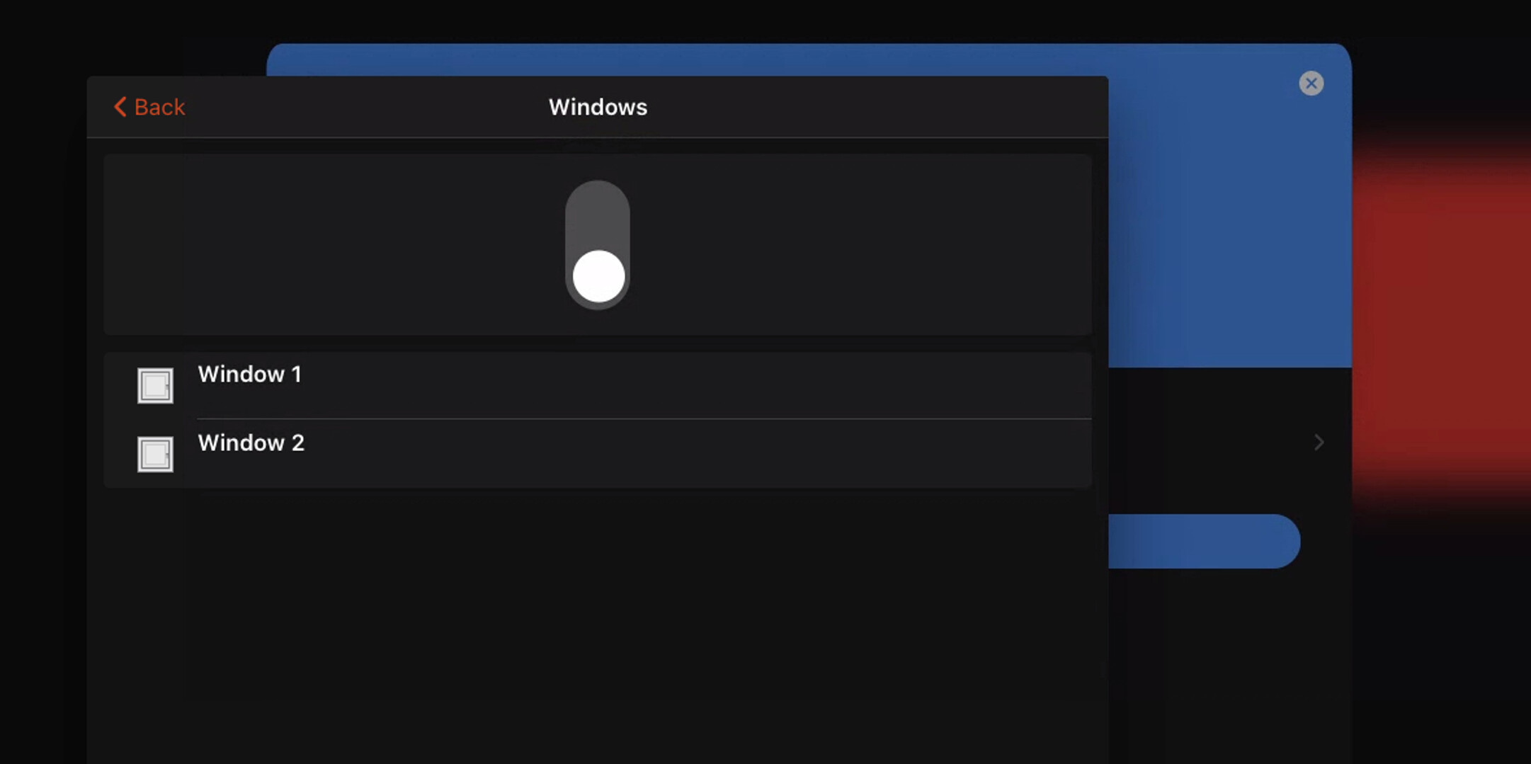

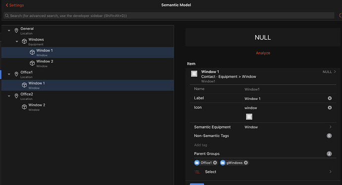

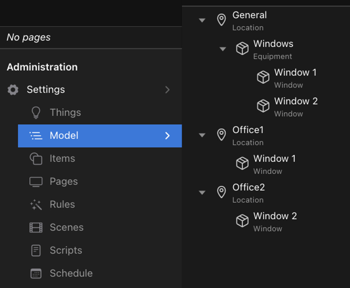

Model (one “Windows” item):

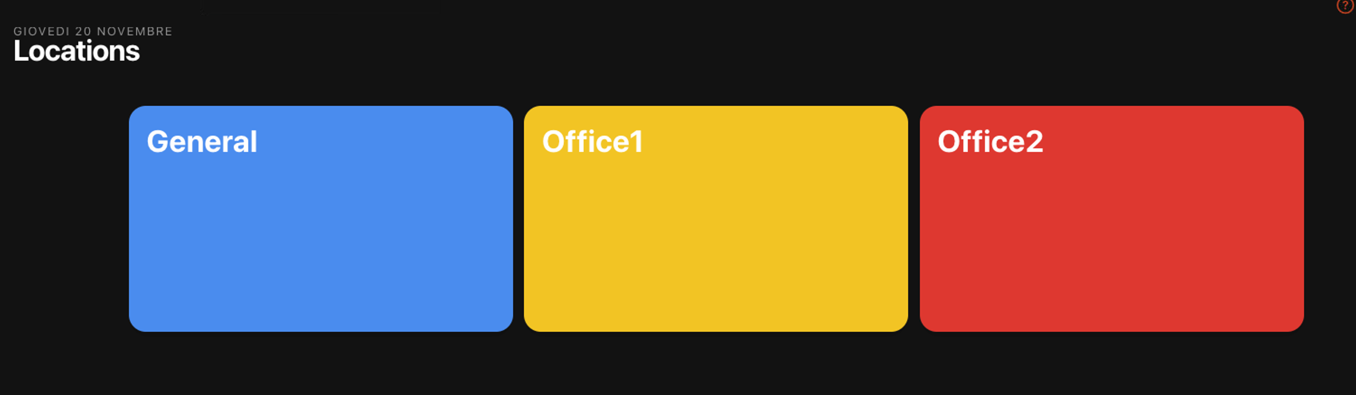

User interface:
General
Office1 and Office2

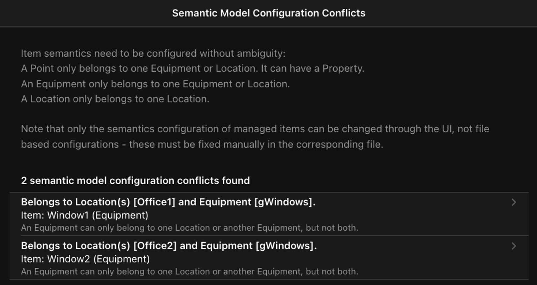

All is working correctly but now I have this errors:
Your arrangement simply goes against the philosophy of the model. You can ignore the conflict warnings, but there’s a high probability of unpredictable results in the long run.
The model is intended to represent the true physical layout of your space. Locations mean actual physical locations and equipment should represent actual physical things. In that way, you cannot have the same physical thing located in two physical locations. So, the model tells you there is an error in your configuration.
The problem is not that you have all the windows in another group, this is a very common arrangement. The problem is that this “all windows” group isn’t really a part of the semantic model because “general” cannot really be a location and “all windows” is not a single physical thing.
If it is absolutely required that you have some UI access to that all windows group, there are some work-arounds/hacks that can get you access through the model pages, but the simplest and best solution is simply to remove the semantic tagging from your all windows group and use a basic widget to add access to that group on your overview page instead of trying to see it on the model pages.
