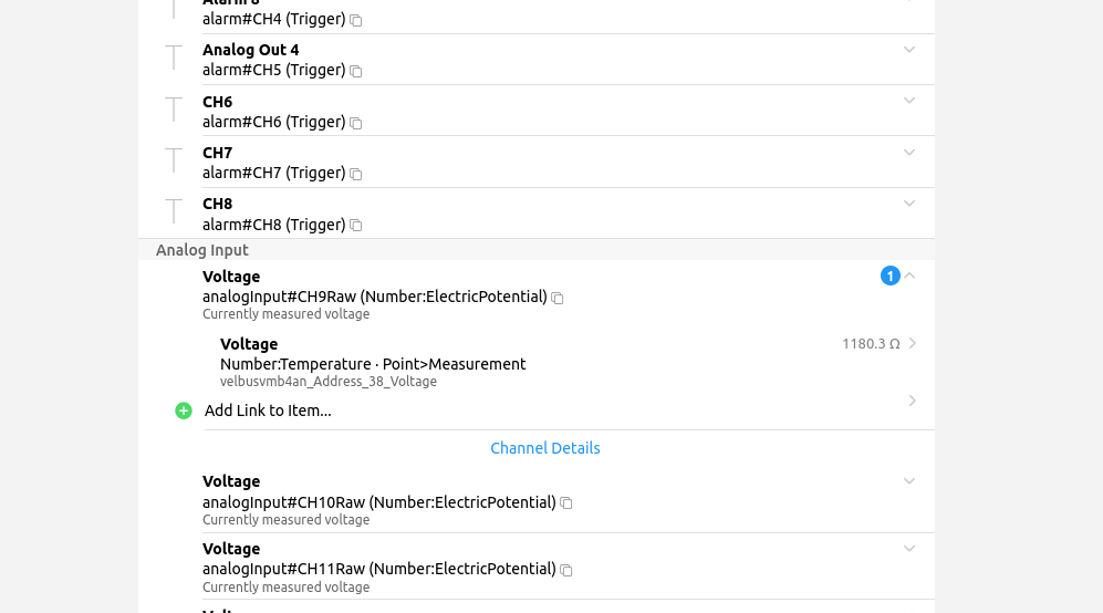

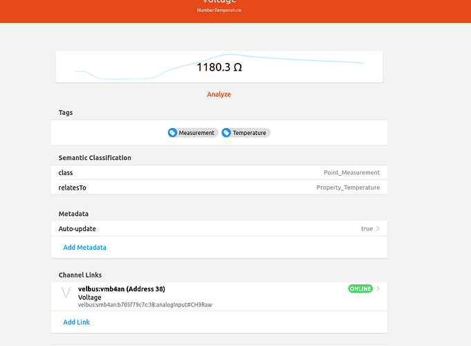

Hi
hmm on the Switches in Velbus i can see the °C.
Witch Tab in VelbusLink do you mean.
in Oh3
With the VMB7IN i have the only problem on the webpage
grafik
it shows only the 0 or the 1 everthing without dot and the follwing numbers
thx Markus
That looks correctly set to me.
Oh, I see what you mean.
I’ll need to test this when I get back to my office.
In the mean time, maybe one of the Velbus binding developers can help shine some light on why your seeing the raw value and not the converted UoM value.
