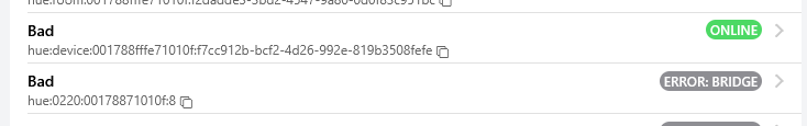

  • I have some itemes that I cannot remove from my environment.
    Some time ago, I have switched ot a new Hue configuration and included all new items newly.
    Now I cannot get rid of the old items.

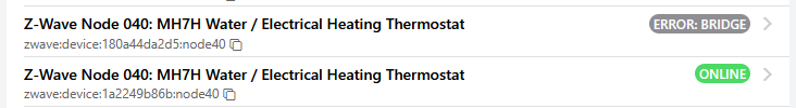

    Here an example:
Similar issue I have with Z-Wave things when I had to reintegrate my controlle and got a new controller ID –> all items had to be ihcluded newly’
The “old” controler ID is not available any more, and I changed all things in the definition file with the new controler ID
Any Idea how I can clean up my system?

It happened when I was switching to Philips Hue Bridge supporting API v2.
Items are defined manually, but I switched all items to the new bridge, no old items are available anymore.
Same with the Z-Wave bridge …
