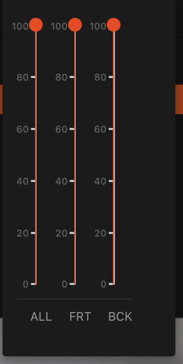

I’ve just created a rule (still slightly WIP) to manage the blind moves and then I created a simple widget the provides the option to manage three sliders attached to proxy dimmers, each representing a group of blinds.

When the slider is moved; the Rule is executed.

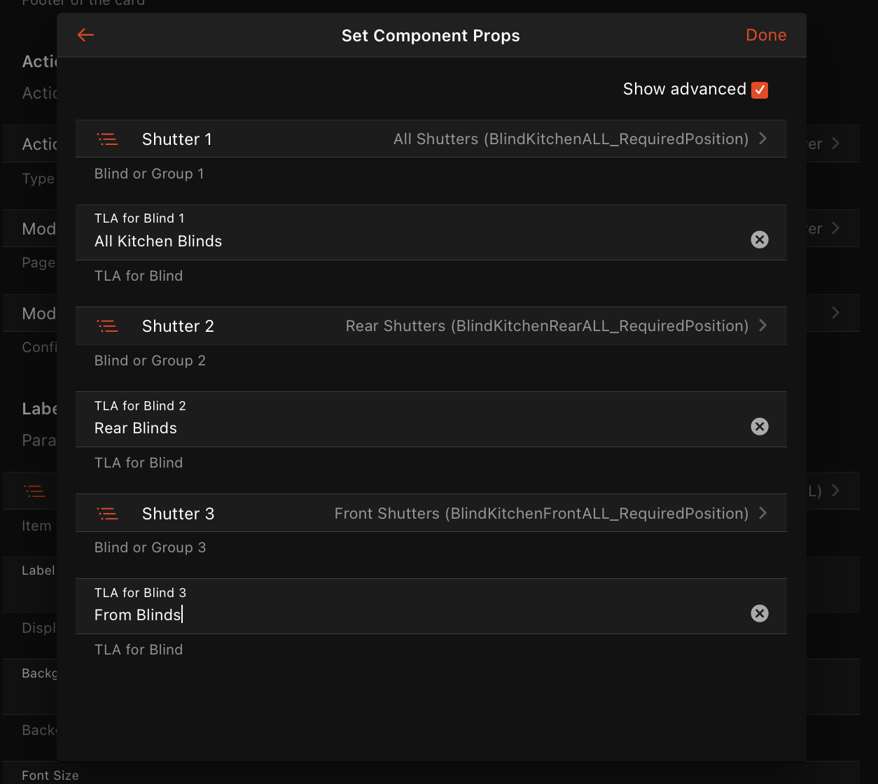

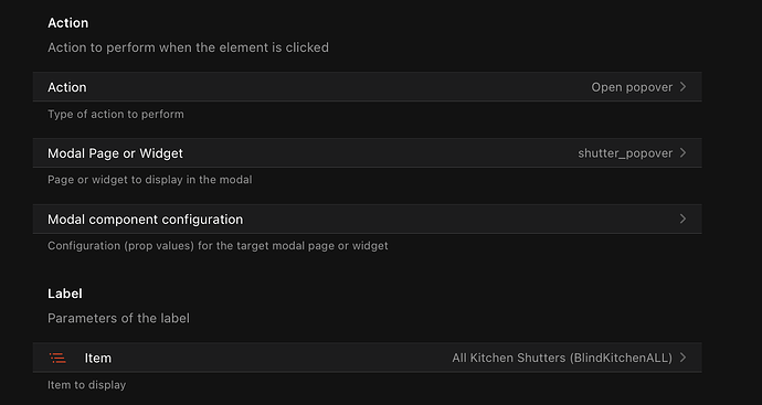

And to hook it into the UI. I just added the widget parameters to the default Standalone & List item for that piece of Equipment (Kitchen Blind) and the respective Point (KitchenBlind_Control) - again, so so super easy in OH3!
So now whenever they go to that Room on the OH3 app, and look to move a blind they get the Schrödinger’s cat widget pop up automatically.
