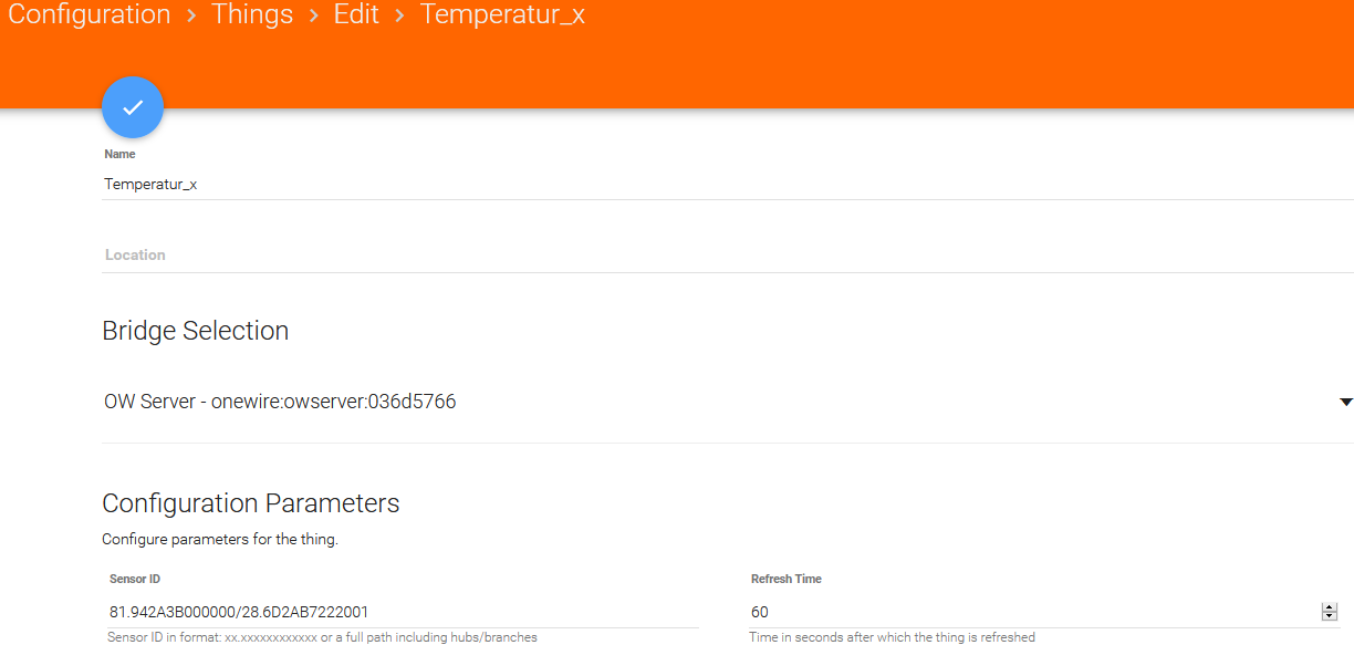

Dear openHAB community,
I’m trying to connect some DS18X20 via OneWire Binding to opanHAB.
As I’m a newby I configure in the Paper UI.
The Sensors are visabel at the owhttpd and owserver (owdir).
That should be correct. On the other hand: why don‘t you use discovery? If the owserver thing is configured correctly, all sensors should be automatically discovered.
I’ve made an update of openhub.
Great software, everthing works perfect now.
Even all of the adress variants I’ve tried out where working.
Thanks to you for the quick help and thanks to the openHab developers for the gorgeous code!
