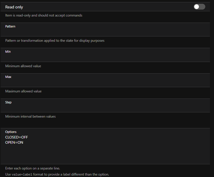

I was thinking somewhere in that direction, but haven’t used map transformations yet. The link you shared only seems to adress a file based solution? How does it work in Main UI?
Make sure you have MAP transformation installed from the Add-on Store. Then go to Settings>Transformations. Create MAP from there. (Take a second to give the Transformation ID a familiar name. It will be easier…)
On the item (assuming it’s a switch at this point) select MAP under profile, and in the Filename field your created MAP transformation should show up.
Aha, thanks. I didn’t understand it was an add-on.
I assume the transformation type is MAP?
Yes, or any other transformation you may need.
