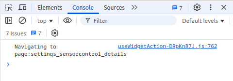

What do you see in the logs? When you engage the navigate action, there should be a log line that says “Navigating to [PAGE NAME]”.
Nothing is written in the log, by default most packages are on error log level, i guess i need debug or trace.
Do you know what is the package name responsible for main ui ? Like org.opebhab.xxx or org.eclipse… Etc.
Thx
Sorry, my mistake, the navigation action is logged in the browser’s console, not the openHab logs. Like this:
