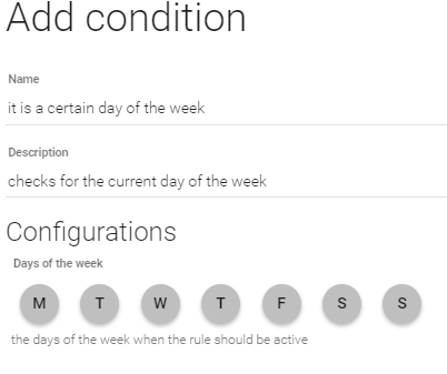

Function doesn’t allow selection of days.

I’m also experiencing this problem.
It is related to JS error:
TypeError: Cannot read property 'days' of undefined
at Object.link (OPENHABURL/paperui/js/app.js:1:4706)
at OPENHABURL/paperui/js/angular.min.js:16:56
at ja (OPENHABURL/paperui/js/angular.min.js:81:35)
at m (OPENHABURL/paperui/js/angular.min.js:66:274)
at g (OPENHABURL/paperui/js/angular.min.js:58:481)
at m (OPENHABURL/paperui/js/angular.min.js:66:214)
at OPENHABURL/paperui/js/angular.min.js:58:119
at OPENHABURL/paperui/js/angular.min.js:62:492
at d (OPENHABURL/paperui/js/angular.min.js:59:474) <div day-of-week="" multi="{{parameter.multiple}}" ng-required="{{parameter.required}}" ng-model="$ctrl.configuration[parameter.name]" class="dayOfWeek col-xs-12 configContainer ng-pristine ng-untouched ng-valid">
