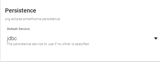

here is the persistence config.
Strategies {
default = everyChange
Items {
* : strategy = everyChange, restoreOnStartup
All items in question were created with paper ui.
