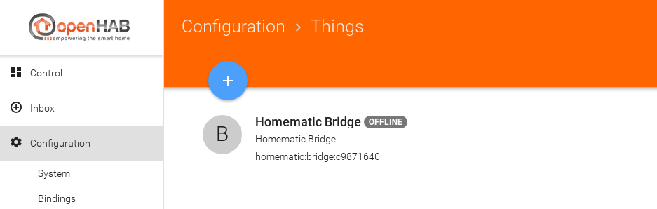

Both (Homegear and OpenHAB2) are still running, but I didn’t get a connection to the homematic…
In homegear I paired my devices w/o any problems. That’s working (same behaviour like OpenHAB1). I saw with “peers list” my devices.

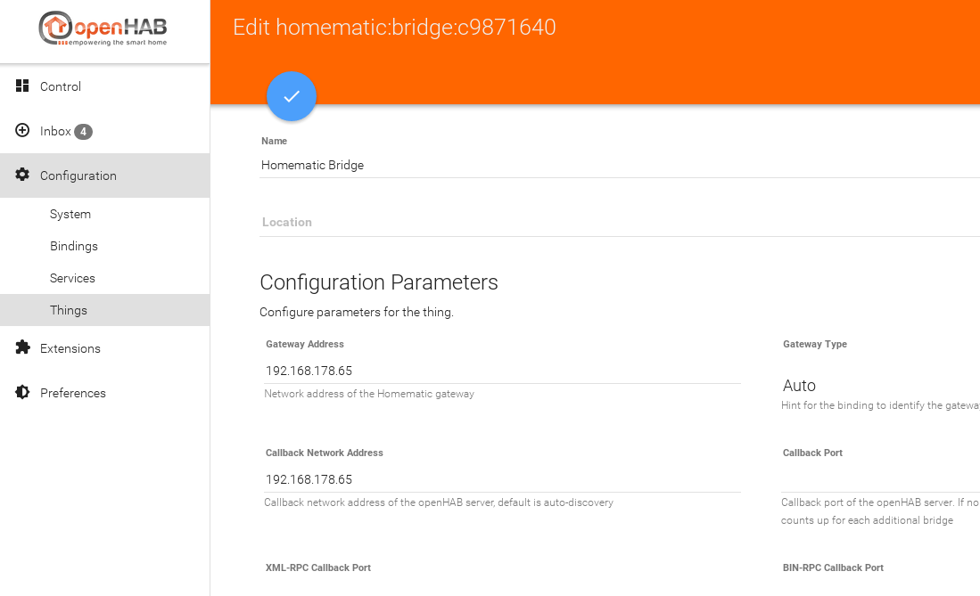

In openHAB 2 I install with PaperUI the homematic-binding and bring in the IP Address for the HM-CFG-LAN.
But no connection…
I look several hints here in the forum, but nothing helps me…
Perhaps I have made a bigger mistake?
I don’t know.

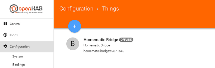

So, I have at the moment no more ideas how to handle it and to get a proper connection…
The same configuration was running as test with OpenHAB 1. I could switch the lights on or off with my smartphone…
And now with my new installation OpenHAB 2…
Nothing…
