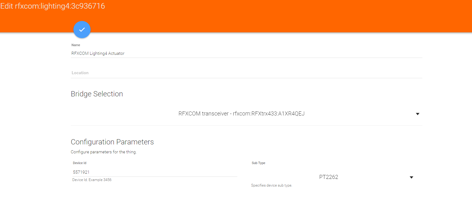

I dont have a rfxcom.cfg? Could this be my issue. Could you post the contents
@pauli_anttila I also think the reason it doesnt show anything in debug is because there is nothing to show. It says rfxcom controller not connected. I am 100% sure debug is enabled, i see it for the switch
Okay @pauli_anttila I really need your help! I gave up on oh1 binding because that didnt connect no matter what i did. I installed a clean oh on win 10 and it auto discovered the bridge and some sensors. The sensors work fine but what i want to do is send commands. Debug is enabled. Please help me, i really want to get this up and running
http://pastebin.com/XHpaUPxt
Those temperature humidity problems should be fixed few days ago, also better reasons for transmitting errors should logged. Could you try latest snapshot from cloudbees (https://openhab.ci.cloudbees.com/job/openHAB-Distribution/)? Change also rfxcom binding log level to trace level to get as much information as possible.
Downloaded the new. Doesnt give errors only when i try to send commands. How do i change it to trace? It isnt documentet? @pauli_anttila
In karaf console, you can set log level by command
log:set TRACE org.openhab.binding.rfxcom
Doesnt really help me at all. Just says transmitting error.

@Oliver_Roed_Scholer, I can agree that there is problem with lightning4 messages.
Additional, there still bug in error messages printing. Your error message should be
Transmitting error: Invalid device id ‘5571921’
I don’t have Lightning4 devices my self, and in fact I have not implemented lightning4 message support. But I will take a look.
Lightning4 message seems to have some fixes and improvements on OH1 binding (committed February). I try to merge them soon.
Thank you very much @pauli_anttila . I cant wait for it to hopefully work :slight_smile:
Please post update when it is ready
@Oliver_Roed_Scholer, lightning4 message integration have some problems. Discussion can be found here. Maybe you have some ideas to share as you have lightning4 devices.
