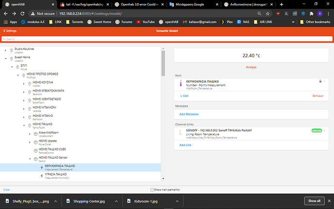

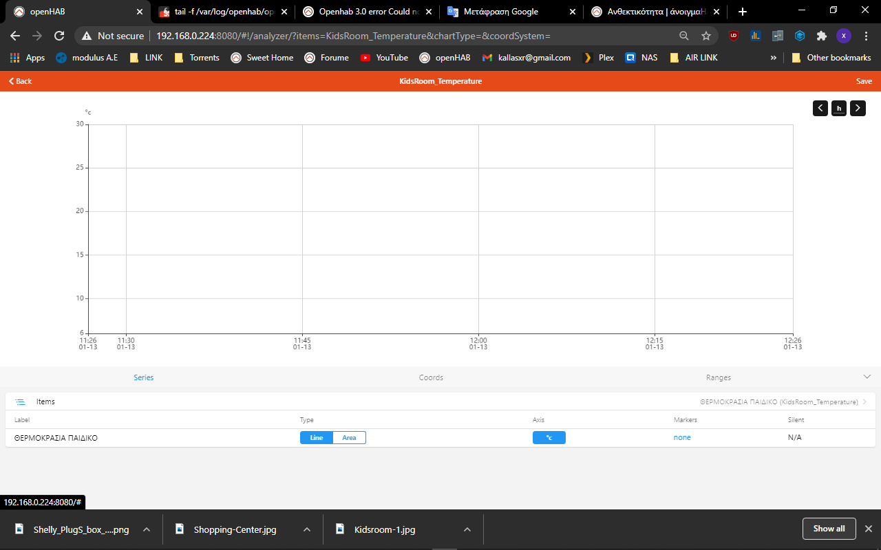

good evening the memory problem is ok.
but it does not show me records of the items I have in the group
could someone help me
I have a setting
// persistence strategies have a name and definition and are referred to in the “Items” section
Strategies {
everyHour : "0 0 * * * ?"
everyDay : "0 0 0 * * ?"
// if no strategy is specified for an Item entry below, the default list will be used
default = everyChange
Each line in this section defines for which Item(s) which strategy(ies) should be applied.
You can list single items, use “" for all items or "groupitem” for all members of a group
Item (excl. the group Item itself).
Items {
// persist the Item state of Heating_Mode and Notifications_Active on every change and restore them from the db at startup
// Heating_Mode, Notifications_Active: strategy = everyChange, restoreOnStartup
gpersistence* : strategy = everyChange, restoreOnStartup
// additionally, persist all temperature and weather values every hour
gpersistence* : strategy = everyHour
