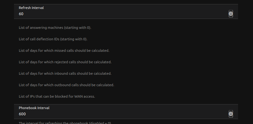

Currently it looks like the UI has some issues displaying some advanced configuration parameters. I am not sure if this is an UI issue or a malformed configuration description. The UI probably expects a list of options here …
I already filed an issue for further discussion.

Why is limitToOptions true? I thought this is only set if options are provided at all. This needs to be fixed in the config description.

The flag limitToOptions is true by default. I am not aware of any kind of business logic which sets it to false otherwise.
Extraction from JavaDoc:
     * @param limitToOptions specifies that the users input is limited to the options list.
     *            When set to true without options, this should have no affect.
     *            When set to true with options, the user can only select the
     *            options from the list When set to false with options, the user
     *            can enter values other than those in the list
Regarding my comment above: @ysc already submitted a fix for it which is available in snapshot build #2014. Thanks again.
