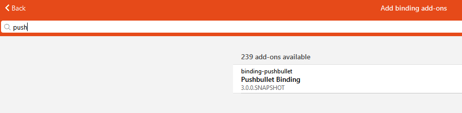

The new Pushover Binding seems to be missing:
Never mind, it’s only in M4, not in the snapshot from the same day :frowning:

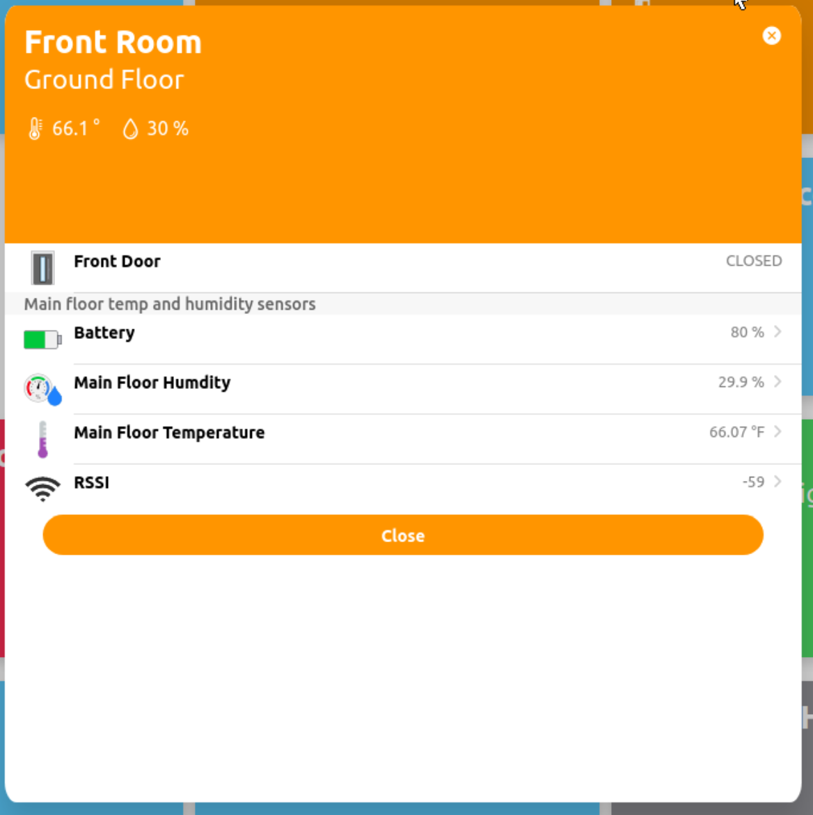

A much greater emphasis on building a semantic model with your Items so UIs like the following can automatically be created.
A list of breaking changes will probably be included, as always, in the announcements. I think there will be a migration tutorial. And there is a good start to getting started docs at Getting Started with OH3: rewriting the tutorial - 1. Introduction
