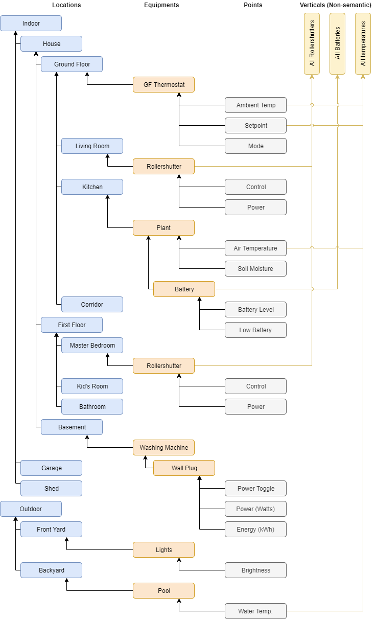

In summary, I’m trying to get the “Verticals” information as in here:
Reading the documentation, it is expected to have a point into several groups (you can set it through GUI and through text files) so, why aren’t shown in the semantic model tree? It doesn’t sound like an expected behavior, isn’t it? Why if not will you allow to set a point to belong to several groups?

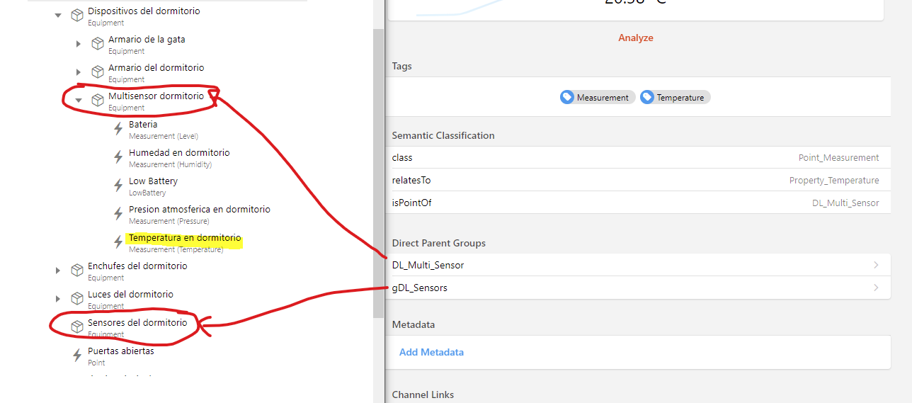

One issue I see is that if you set an item to belong to more than one group, at the Semantic Model view it is shown only in one of those groups (not able to get the pattern of which one).

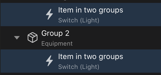

Actually for me the semantic model is capable to show the same item in two groups:
Just go into items → Group → Direct Group Members → Change and add the item to a second group.
EDIT: I notice, if you attempt to add the item into a third group it is indeed not shown in all groups.

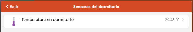

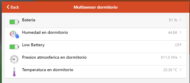

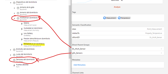

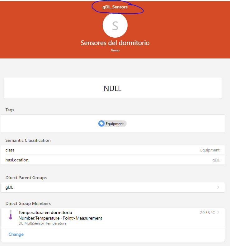

At least in my case it fails with 2 groups:
It fails to be shown into semantic model tree. Into new UI it seems to be able to know the item is in both groups (the “group per physical device at room” and the “group per all sensors at room”
Why do you need “Sensors del dormitorio” and, if you do need it, why does it need to be part of the model? But putting the sensor Equipment or Points into that room it’ll already be a sensor in that room. There is no need to create yet another Group to represent the sensors of the room, at least not for the model’s sake.
The way the model is designed to work is:
  • Room
    • Equipment
      • Point
        With the information presented, I think your gDL_Sensors should not be a part of the model in the first place. It is not required nor even expected that all Items and Groups will be part of the model.
Thank you @rlkoshak for your comment. I’ll look into it but, if you don’t mind: if an item is allowed to belong to several groups (and it is allowed by “Direct Parent Groups”/“Direct Group Members” options), why is not showing them in those groups but only in one an expected behavior?
I mean, based in your comment it is clear I misunderstood the way the model is designed to work (I’ll change my layout accordingly) but still wondering the use case of having the chance in GUI (and text item definition) to have the same item in several groups if what I thought was the usecase turns out not to be the expected one.
Thank you

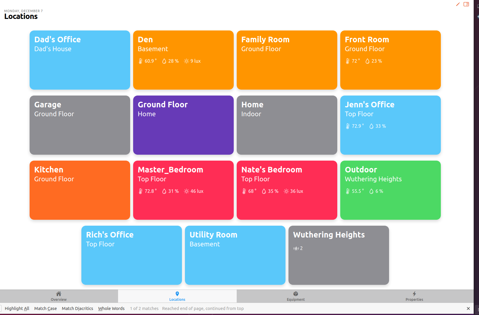

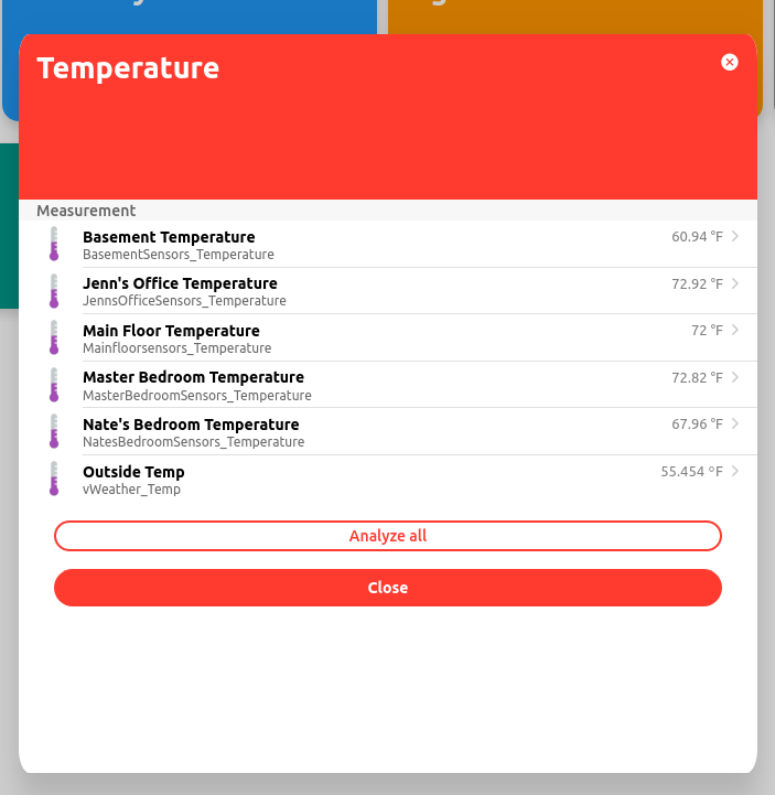

But beyond that, the UIs that are generated automatically don’t need the extra Groups either. For example, if I want to see the temp in a certain room I can go to the Locations tab.

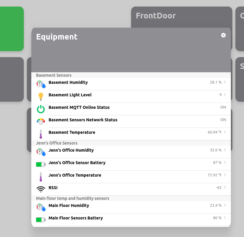

If I want to see all the sensor equipment I can look at the Equipment tab (note I’ve not properly tagged my sensors in the model yet so they just show up under Equipment instead of something more meaningful.

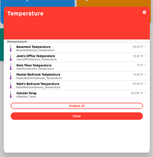

And if I want to see all the thermometers at once I can go to the Properties tab.
I didn’t create separate Groups for these different views. The software is able to figure out what goes where based on the model. So, unless there is some rule or you have sitemaps or something that needs a separate “all sensors” Group there is no need to create one. The model can figure out all the sensors without it. And if you do have a rule or sitemap that needs such a Group, there is no need to add that Group to the model.
